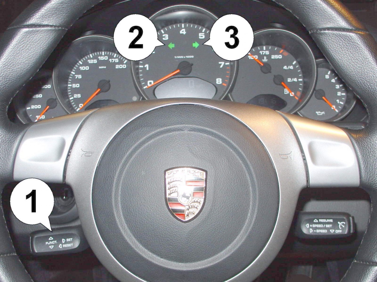

smartTOP is on my todo list...
keep windows down after top opening
open top remotly with key.
http://www.mods4cars.com/sms/shop/in...action=manuals
I bought my car used. so I was hoping for the unit to be in there... I tried entering in "programing mode" but nothing happend...
according to smarttop manual:
All programming is done by using the onboard computer stalk on the lower left side of the steering column (1) and the two green turn signal (indicator) arrows. Functions are indicated by the left arrow (2) and their settings are indicated by the right arrow (3). Navigation is done by pushing the stalk up (next function) or down (previous function) and settings changed by pushing the stalk (increase setting by one) or pulling the stalk (decreasing setting by one). Each time either a new function is selected (UP/DOWN) or a function's setting (setting) is changed (PUSH/PULL), the arrows will indicate the new status by first blinking the function (left arrow) and then the setting (right arrow). To enter programming mode, first make sure the key is not in the ignition lock and all doors are unlocked. Pull and hold the stalk until the left arrow blinks once to indicate function 1. Now let go of the stalk.
