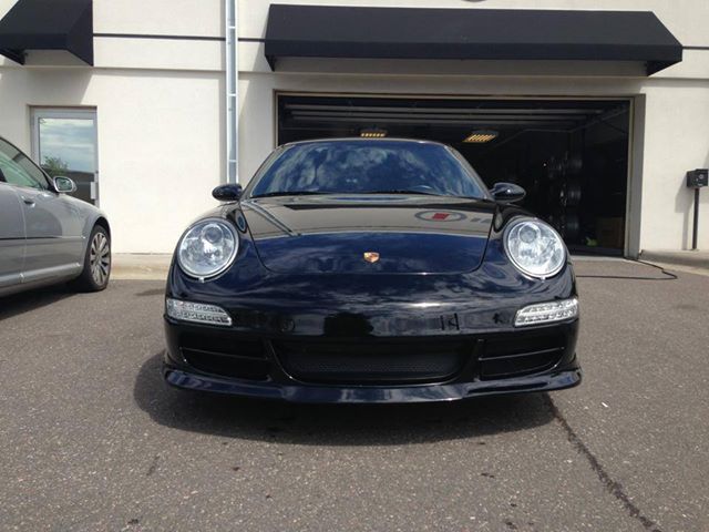

Cracked overflow tank
Here's a photo of the 3rd radiator after install. The work was done by IMOLA motorsports in Golden Valley, MN

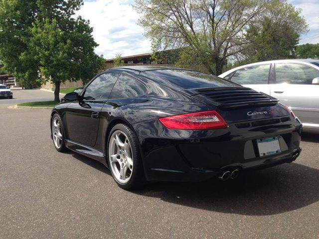

And from the rear
