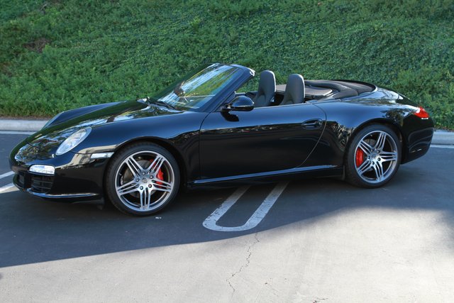

Purchased a 2009 C2S with 20k miles 11 months ago. At that point the car was CPO'd by the dealer. It now has 24,000 miles.
I got a notice on the car that it is due for a service in 29 days. I decided to check the oil level this morning and it was on the lower end of the bracket.
Given that, should I just add some oil or take it in for its service now which would include an oil change?
Also, what should I expect the service to be when I take it in? 3 year & 24,000 miles?
Thanks,
Jason
