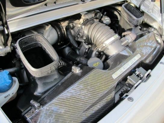

If you have a Tip then you'll have a third radiator. Usual evidence of X51 package would be the custom air box in the engine bay. If neither, then third radiator was probably added. I don't believe it was a separate option code. There are kits -

Here is my X51 airbox. Hope this helps -
