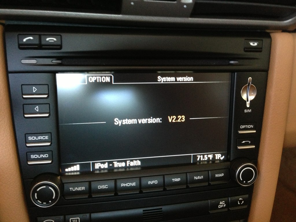

Check your system version...latest for PCM 3 units is v2.23.
It fixed the problems I was having.
You know, I asked the Tech that very question the last time they had my car last week, and the guy swears that the latest firmware version for the PCM 3.0 is 1.47, which is what they installed 2 trips ago. I think I saw your post on this
previously, and specifically asked him. I'll check again today....

Thanks DJS. You know, I asked the Tech that very question the last time they had my car last week, and the guy swears that the latest firmware version for the PCM 3.0 is 1.47, which is what they installed 2 trips ago. I think I saw your post on this previously, and specifically asked him. I'll check again today....

Show him this!

I should add though, my dealer had a hell of a time getting the system to accept the upgrade (which also included 2012 maps.) They had to replace the PCM under warranty to make it work.

Awesome, thanks. I'll shoot this to him now - love the photographic proof!
