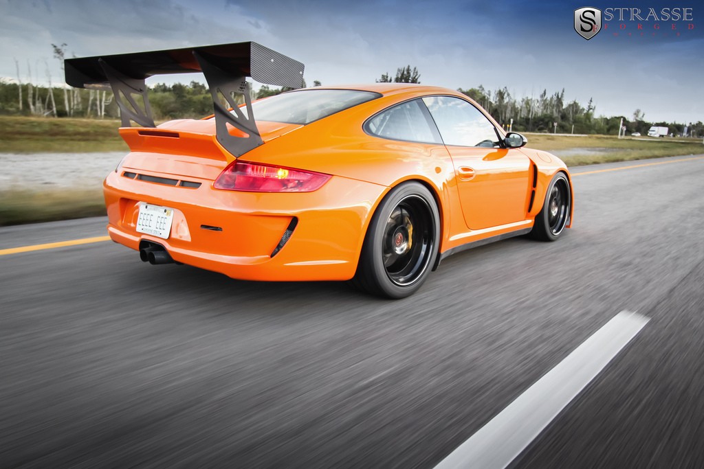

You have to add part n°: 997 505 641 03 (attachment strip center) and remove yours.
Ask me how I know...
What. The. Hell. Is. THAT?!? OMFG I want it I want it I want it!! Seriously, what intake/wing is that??

MJSpeed,
The part # you gave me is for a bumper support. Im not sure what you mean? Your car has a GT3 conversion, im looking to convert my stock 997.1 to the never 997.2 with LED tails. I already have the tails + adapter, im just looking to find out what else I need to get the rear bumper on properly - namely the bumperette pieces

Originally Posted by adnanm3
MJSpeed,
My car started life as a 2008 GT3RS. I then converted the front to a 2009 CUP S widebody and the rear bumper to a 2010 Cup modified to be used with the 2008 lights. The decklid on the outside is the 2011 GT3R one, on the inside it's the 2009 Grand-Am one with the intake also from a 2009 Grand-Am, with one major difference, mine has a MAF Sensor...the uprights are from Porsche Motorsports. The wing is an RSR wing. Everything except the uprights are Carbon Fiber including the little piece in front of the decklid. I also have a Carbon Fiber hood (I also have a couple of them for sale in the classifieds).
The bumper support on a 997.1 and a 997.2 are different, so you will need to purchase the part and replace your old/original one.
