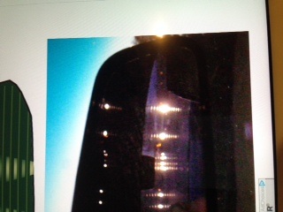

Old Oct 4, 2013 | 04:57 PM
JP911C4S's Avatar
Joined: Aug 2013
Posts: 39
From: New Jersey, USA
Rep Power: 14
JP911C4S is infamous around these parts
Headlight reflection on tinted rear window
Here is the problem...

With a microfiber cloth between your finger and tint film... run it parallel over each defroster line pressing firmly to get the film to adhere as close as possible to it and the glass. Same thing around edges of any glass where the dot matrix is. Doing this each day for about a week after install will not completely eradicate the issue but will minimize the distortion effect you are experiencing.
Good luck

It also appears to me that the tint is not totally flat due to the defroster lines. And if the surface is nor flat you will get a distorted view.
I ll check my other car, as it has rear tint, to see what it looks like over the defroster lines.
How long ago was it done? Park it in the sun to help it dry and hopefully get tighter.

I'll let you now in few weeks. I found out that the film I used is the culprit of the extreme glares I am experiencing. My inexpensive Tinter used solar gard HP-Smoke -35 which is metalized film. "You get what you pay for " is absolutely correct
I plan to strip off my current film on my rear window and replace with 3M at a reputable Tint place (2x$) which I should have used in the first place -- lessons learned!
I am waiting for a sunny day in NJ. It's a lot easier to remove film with a chemical treatment when sun is out (rather using a heat gun). More time wasted and more $ in the end - "measure 2x before you cut" - should have done more HW
