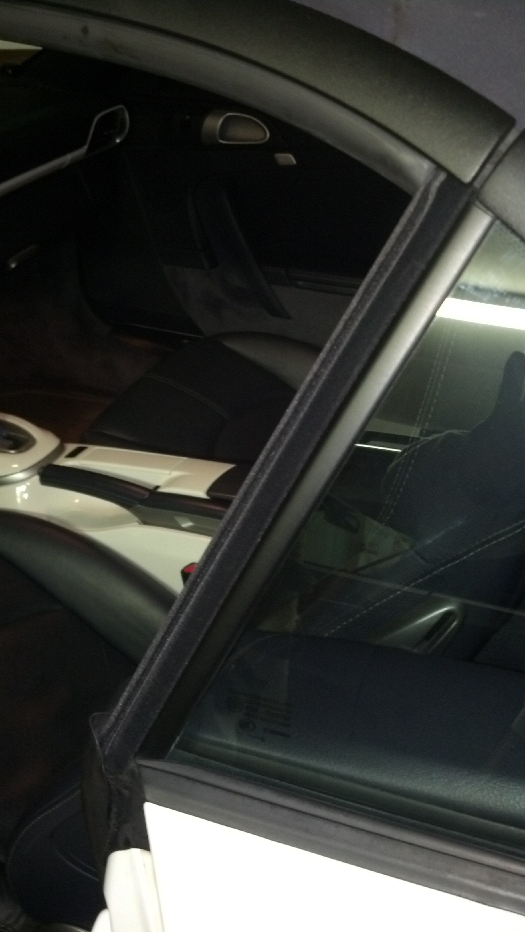

You guys are correct . Took me all of ten minutes and some soapy water. Looks like new. Old ones were worn pretty bad and caused a little cabin noise. Saved me a couple of hundred . Thanks for your help.......

Here are the pieces I installed . Cost me $80...

nice informative DIY! Thanks for sharing!
