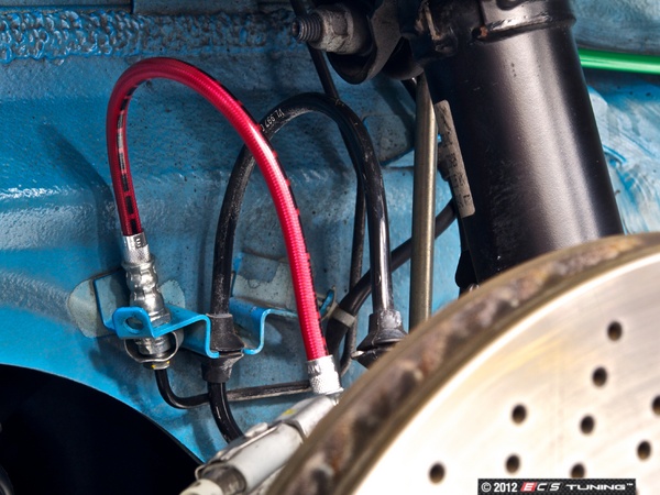

ECS Tuning - Porsche's Avatar
Joined: Mar 2012
Posts: 9,607
From: Wadsworth, OH
For any one interested, we actually have our Stainless Steel Brake Lines on sale for the Holidays. For more information Click Here. If you have any questions or concerns feel free to PM me.
