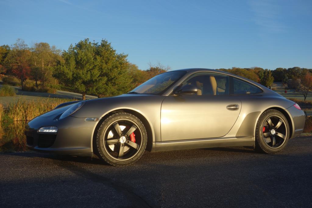

Snow Choice -
My selection was to go with Michelin Pilot Alpins 235/40/18 fronts and 265/40/18 rears with black Andros Spec P rims from Damon at Tire Rack. About $2180 plus shipping with TPMS installed all around. Video taken a few days ago when we had the first freezing rain and snow fall.
