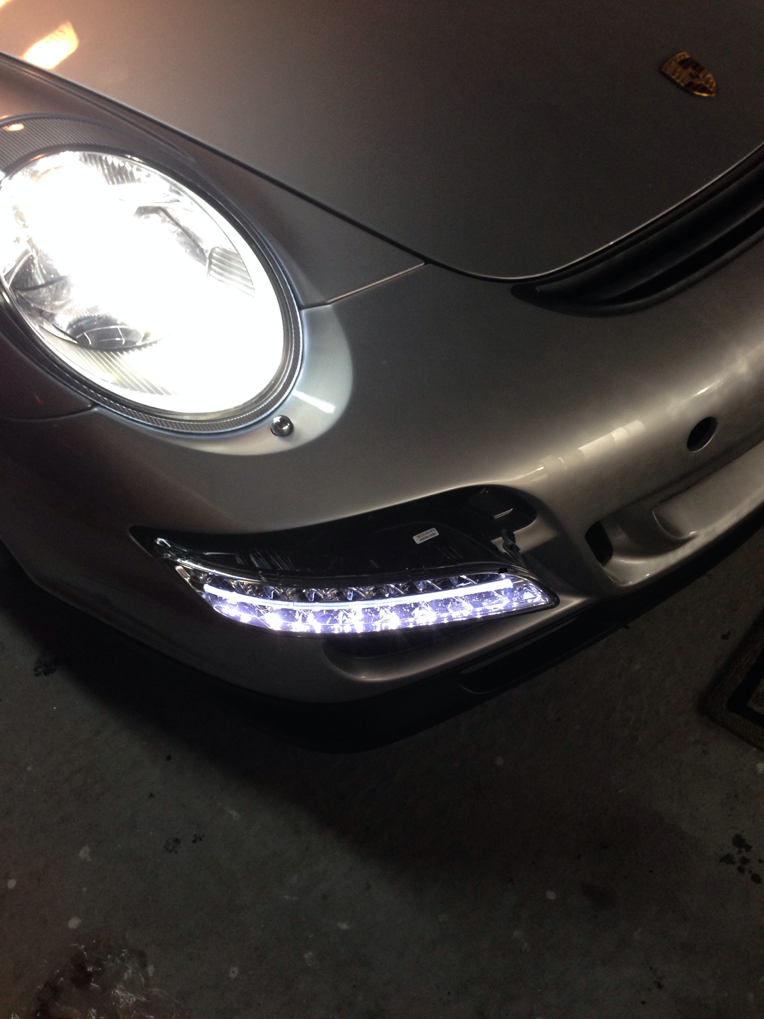

Hey Pete did you ever fix the problem? Im having a issue with my drl. Driverside works but the pass side led strip wont light. I personly dodnt wire up the lights just curious is there a way i can just nix the led bar on the driverside? Thanks

I had a similar problem recently with mine and I found that the cause was a connection that disconnected. I had to get the lights out and reconnect it, and now all is good. Hope that helps

Thanks jack! Going to look into it today it was working before maybe like you said it got disconnected thanks again

Yessss gotem!!! They work loose wire!!!

My prob was the connector from the drl that clicks over to the oem wire the drl little clip has a little metal wire that transfers the power was loose so i fixed them with some needle nose pliars.
