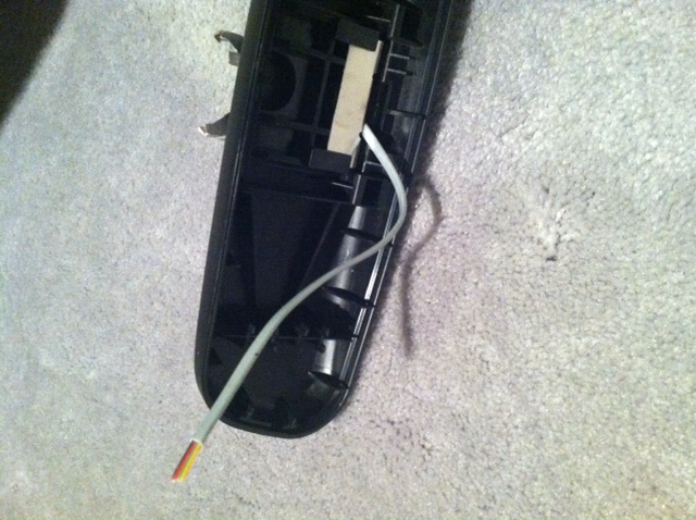

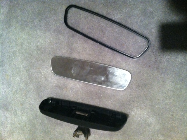

I recently purchased my first p-car and for some reason I want to start changing everything. Maybe it's the weather, maybe boredom.
But here goes....
Looking at this and other forums, it seems people are putting there radar detector displays inside the rearview mirror. Wow.It looks cool.
I had to see if this was something I wanted to get done professionally.

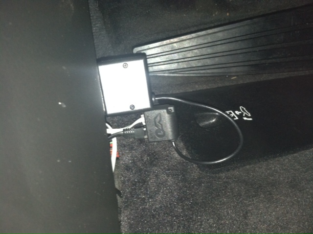

I chose the V1 because the Savvy makes the installation that much quicker(no hardwiring).
Thanks to 6speed and youtube, I learned how to remove the mirror.
ID:	336823   Click image for larger version

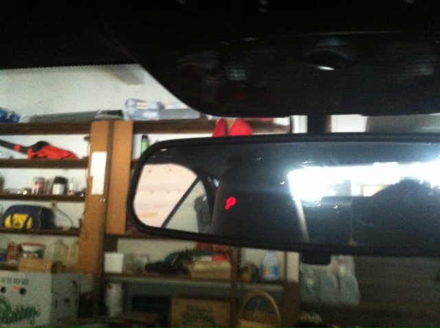

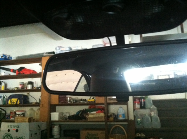

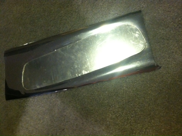

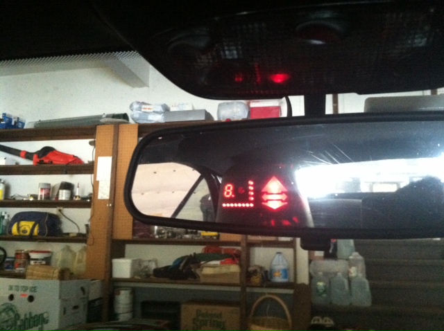

Next I spliced the wires to fit it through the mirror .Then cut I think 3/8" acrlyc glass with a dremel cut wheel in the shape of the mirror glass.
After I sanded off the edges, I put one way mirror film on the glass.
The V1 display case was taken apart and taped to the back of the acrylic glass.
Done.
I don't like it. It's just awfully distracting to me at night.
Failed.
It will be changed back to stock.

Nice work. Honest review is appreciated! I do like the Savvy unit, not so much for the install but the muting at low speeds. Too bad it won't black out or dim the display lights as well, when under the set speed.

looks good, to bad you dont like it. I can see how it can be destracting at night. Is there a way to dimm the radar?

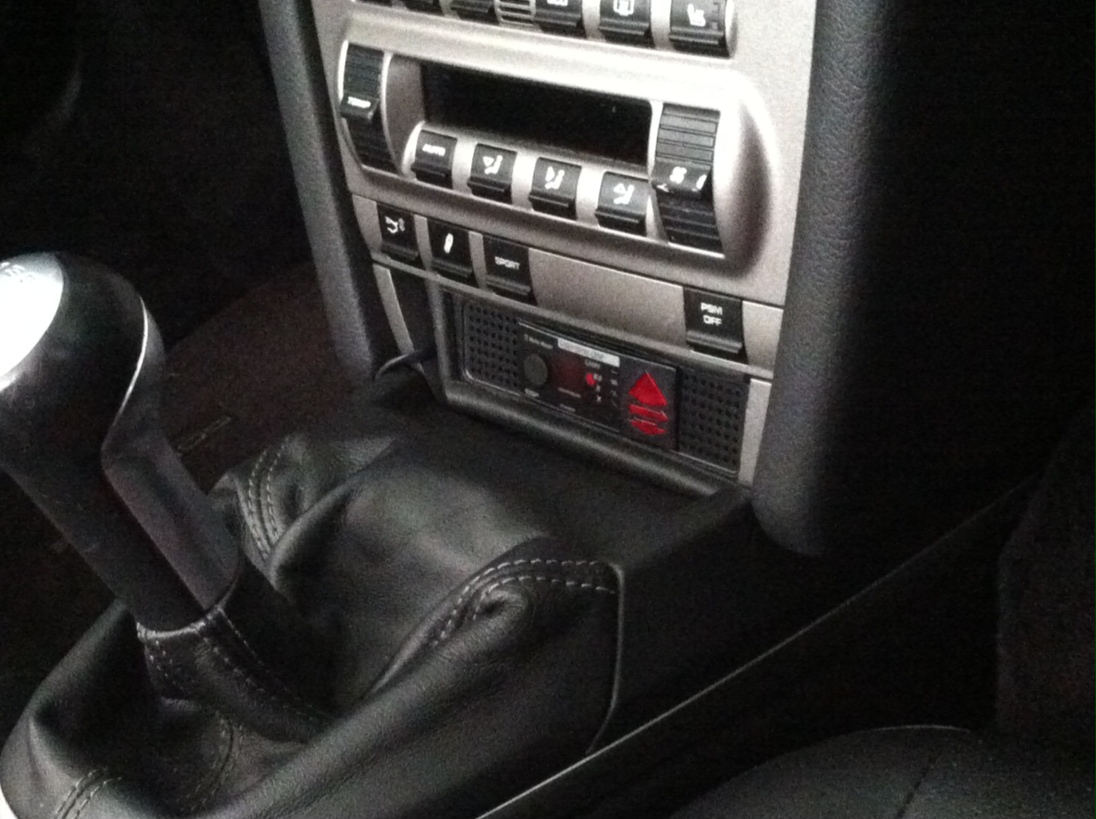

BiteEmNBeatEm looks good, to bad you dont like it. I can see how it can be destracting at night. Is there a way to dimm the radar?
I appreciate it. No, there is no way to dimm the disply lights unless you put tint film over it.
This is where I decided to put the display unit. Out of the way.
I'm thinking of getting the audio mute control to put on my steering wheel, just in case a LEO pulls me over.
