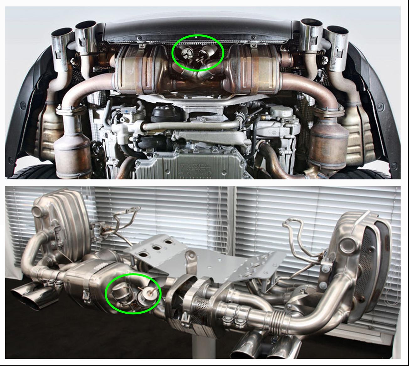

Congrats on your new to you 997. Sounds like PO had PSE added afterwards but then also removed it before selling/trading in.
In any event, I took pic from post #12 in thread you linked and circled the PSE valves you should look for under yours. If not there, then it was taken back to stock exhaust for one reason or another.
Good luck

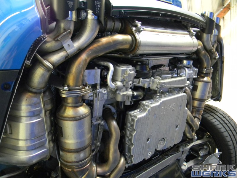

Thank you sir! I believe I may have confused myself, the picture I posted above and the one you circled seems to be the 997.1 design (maybe?), I'm assuming that's what the blue car is.
Sharkwerks shows this as a picture of the 997.2 3 piece design PSE which is what mine looks like.
ETA: Seems the 997.2 has the same center section muffler regardless of if you have the PSE or not. I guess this was a change on the DFI engine.

Indeed AND you took me down w/ you!
You tried to cross ref a 991 w/ a 997(.2)... I have a .1 so I'm not as familiar w/ the .2 underside but it did seem a little too different. At least that is my excuse

Those tips look like 997.2 PSE. Which is diff than 997 PSE (I've had both)

Those vacuum plungers/actuators are actually ON the SIDE mufflers for the 997.2 PSE, if you look around the side mufflers they're visible from below. Are you sure you have the PSE button and you're not looking at the SHOCK button? They do look a little similar if you're new to the car...sort of like porsche using the PSM and PASM acronyms that mean completely different things.

I found the actuator valves last night. From underneath I can see one valve on each side near the outside tailpipe exit. I'm positive I have the PSE button, I know what they look like, this is my third P-Car, but screwed up when I didn't realize the differences on the .2 cars.
My last 911 was a 993 so I'm learning as I go. How exactly does the PSE work on the 997.2's? I only see one valve on each side so I can't determine what exactly it's bypassing, I'm assuming there is some sort of internal valving inside the side mufflers?

Mine is not hooked up...it's just open/loud all the time. Mine was added aftermarket and I bought it that way. I think it just bypasses some of the exhaust around the mufflers and straight out. I also have the Fabspeed X pipe which replaces the center muffler...the whole package sounds awesome! If you search around you can find some threads about how to unplug the blue connector in the engine bay to just leave it open all the time...if you're interested in that. I don't know if you can turn yours on and off with the button at will...or if it's still rpm sensitive?
