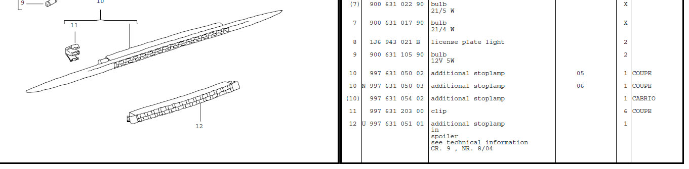

I have lost the clips that attach my extra 3rd brake light to the spoiler.
My dealer sold me the wrong clips (99763120300) that attach the main 3rd light, but not the spoiler one.
My parts manual also doesn't show the clips.
The part number of the light itself is : 997 631 05 01. "additional stoplamp in spoiler"
The parts manual has a note: "see technical information GR.9 NR. 8/04"
I really don't want to spend $100 for a new light, when all I'm missing is two simple clips.
Thanks for any help or leads.
Nick

These clips are an integral part of the assembly. You cannot buy them separately from Porsche. There are three part numbers for the assembly:
U 997 631 051 01 - confirmed does not have the spring clips
U 997 631 051 02 - unknown
997 631 051 03 - confirmed has the spring clips, I just checked mine
The "U" prefix means "Deleted without replacement". Basically Porsche changed the design, likely adding spring clips to the .03 version

^ That is correct, and all those Part numbers now SS to the new part number of 99763105104.
