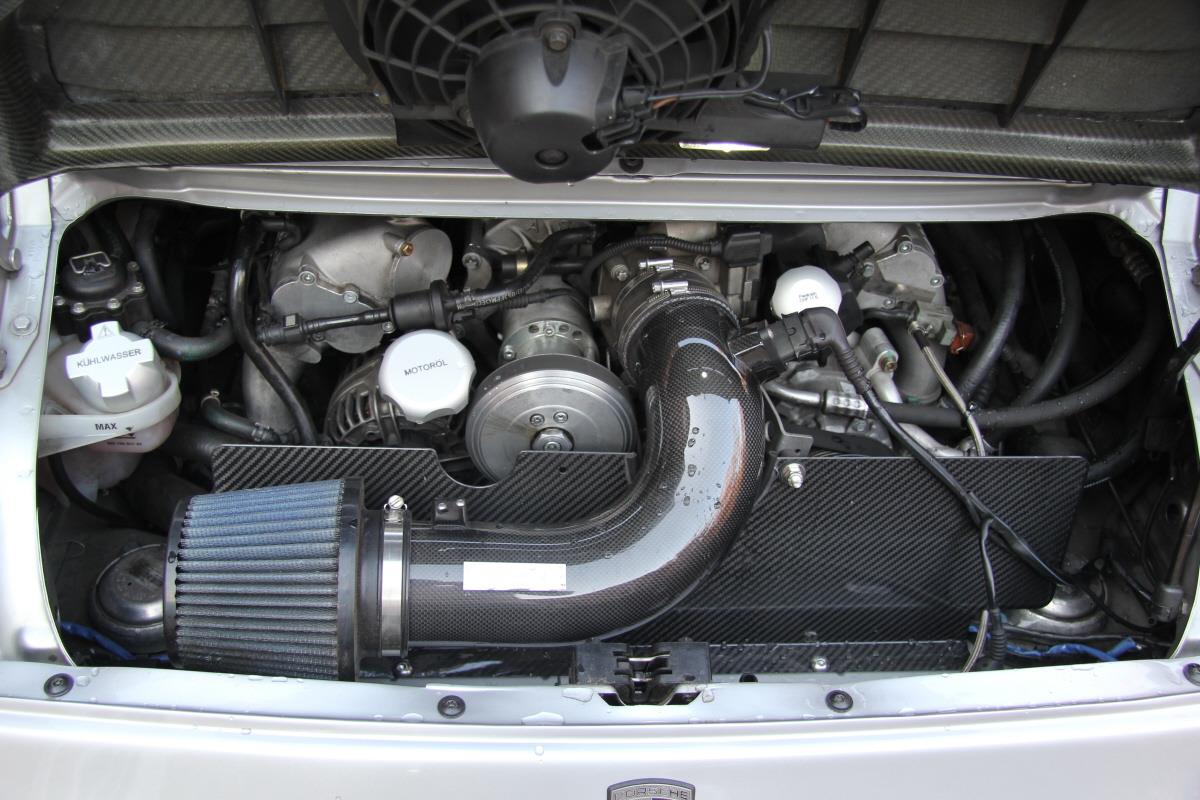

I have a RUF R-Kompressor SC on my 997.1 3.8 C2S. RUF believes that the compression of a normally aspirated non forced induction engine should be lowered a bit and they do a neat trick where they use thicker head gaskets when installing their kits. This creates a little more space at the top of the piston's compression cycle consequently lowering the compression of the engine. Their upgrade is substantial and not just bolting some parts onto a normally aspirated engine. They also do a thorough engine analysis and will decline to install it on cars that don't meet their pre-install conditions. Attached is a photo set of what's included in the R-Kompressor kit. Any of the parts shown in a color are different from the OEM engine parts. All of the above is why the RUF kit costs north of $30k. Would I install someone else's SC kit on a NA engine - personally I would not, I also bought my car with it already installed from the PO and although it is absolutely awesome, extremely unique, and I wouldn't trade it for any other 997 or 991, I also wouldn't pay $30k to have it added to a 997. By the time you pay to have any normal SC EVO, TPC, etc) added, your getting close to used 997 TT $ and that's the safer choice for serviceability and resale, so I'd recommend going that route.
