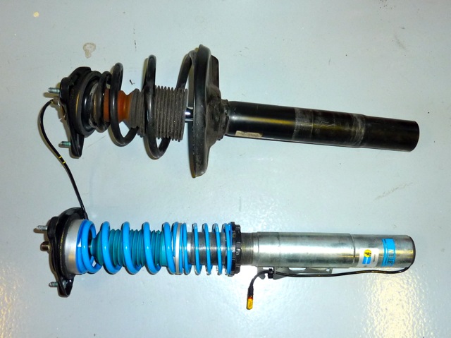

Bilstein Damptronic front springs and perches are much narrower than the factory springs.
so...here's the deal with the wider tires thing...i bought a set of 991 20" rims, beautiful, don't remember the name...anyway, they came with a set of new pirellis, the 245/35 and 295/30's...i put them on the car and the rears fit fine with an ET70, i added 7mm spacers, perfect... the fronts however with an ET55 touch the base of the stock spring setup just enough to keep the wheel from rolling, now as i set here writing this, i can't remember whether i put the spacers on the front as well , i must have, cause if i didn't, all i would need would be those spacers to free it up...i must have ...anyway, i went and got 2 235/30 pirellis, mounted 'em and voila! all is well. however, when i put them on and torqued and stepped back and looked at the car, i realised i can't roll with these, they're too big, just don't look right, so i took 'em off and put them up for sale on ebay kleinanzeige, where they have been for sale for almost a year and its about time for a set of tires on my 19's and i thought i would put these on for the summer since they haven't sold, AND they are much less offensive with the larger tires on the front instead of the235/30 rubber bands...which i could run if i have coil overs , which i have been thinking of doing anyway, the lesser of evils...
