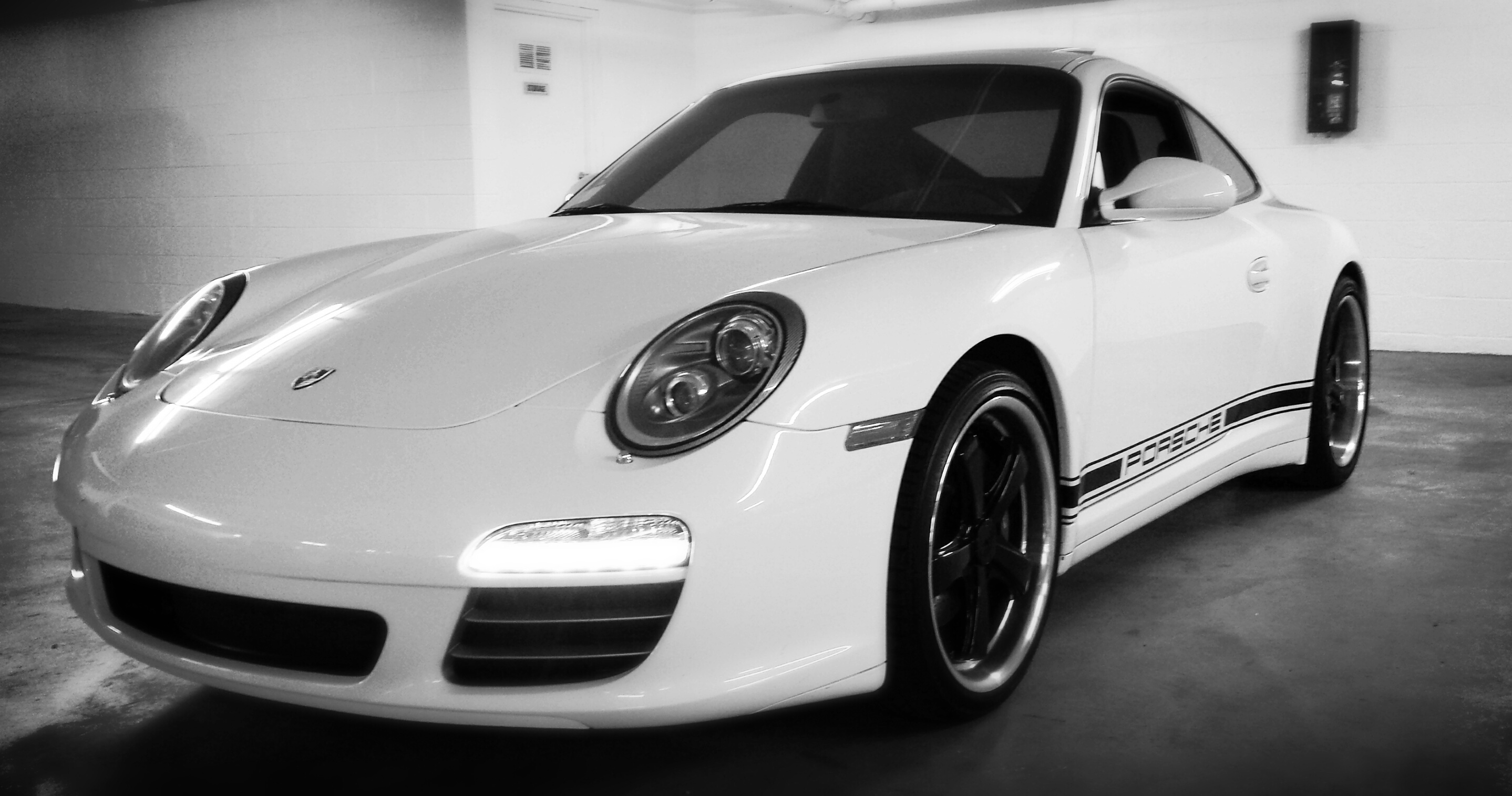

I recently switched from a 997.1 S (2006) to a 997.2 4S (2009) and it's a big step up, IMHO. More power, redesigned 9A1 DFI engine, PDK in my case which I love and the PCM upgrade is great. Sport Chrono Plus and PASM also makes a big difference.
Oil consumption on my '06 was ridiculous, but on the '09 it's WAY less.

Congrats on your new purchase, I may be going that way towards a 997.2S for the DFI.
