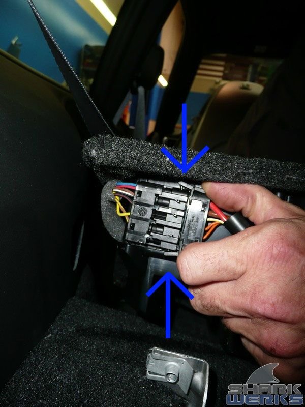

Thank you for the reply, however I still not sure how that answer my question I am not sure where he is taking the sub signals from. I'm not sure where the amp for the bose Bass box is, some places seen to believe there is a dedicated bass amps. I'm confuse.
Can i just get the signals from this harness? feed it to an aftermarket Amp and subwoofer?

Signals in that connector are outputs FROM the Bose amp. Wouldn't you want to tap the inputs TO the Bose amp so that they are unmolested?

Can't remember where I posted it but that wire contains all you need. The socket going to the Bose sub has the power and ground, the two thickest wires. The other 3 wires are remote on, and the right and left signals. These are speaker level outs. The sub has a booster amp. I'm sorry I can't remember where I posted the exact schematics.

what i really want is to build a custom box to replace the Bose Box and add 2x flat subs + Aftermarket sub, this way the OEM look will stay but i'll have more base, to do this i need to know if the Sub signals are on that connector

The signal is there in that wiring. The power is also there including the ground. Let me try to look for the schem and I will post

A2 + signal
A3 - signal
A4 + switched line white and yellow
A5 ground brown
A6 power line red brown
I hope this helps in your quest. The bass is mono anywyas so there is a sidle set of signal
The power isalso adequate for a basslink. Don't know if it will be if you plan on putting a bigger one
