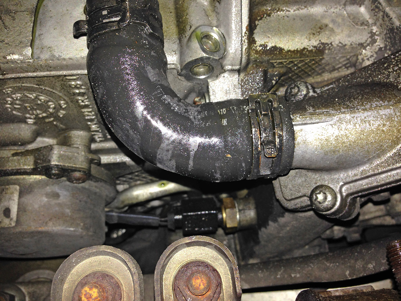

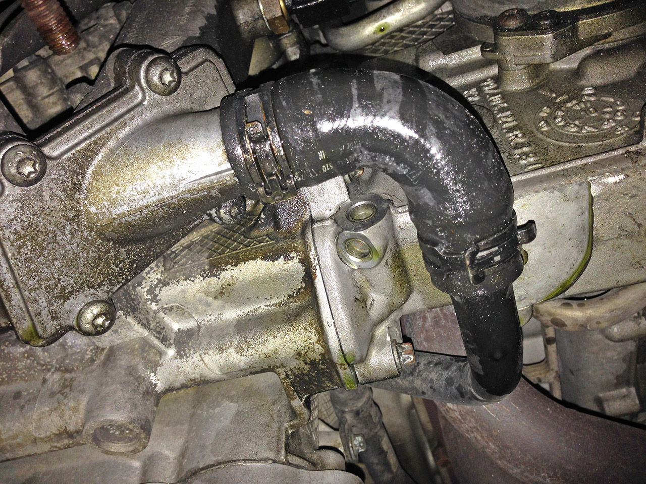

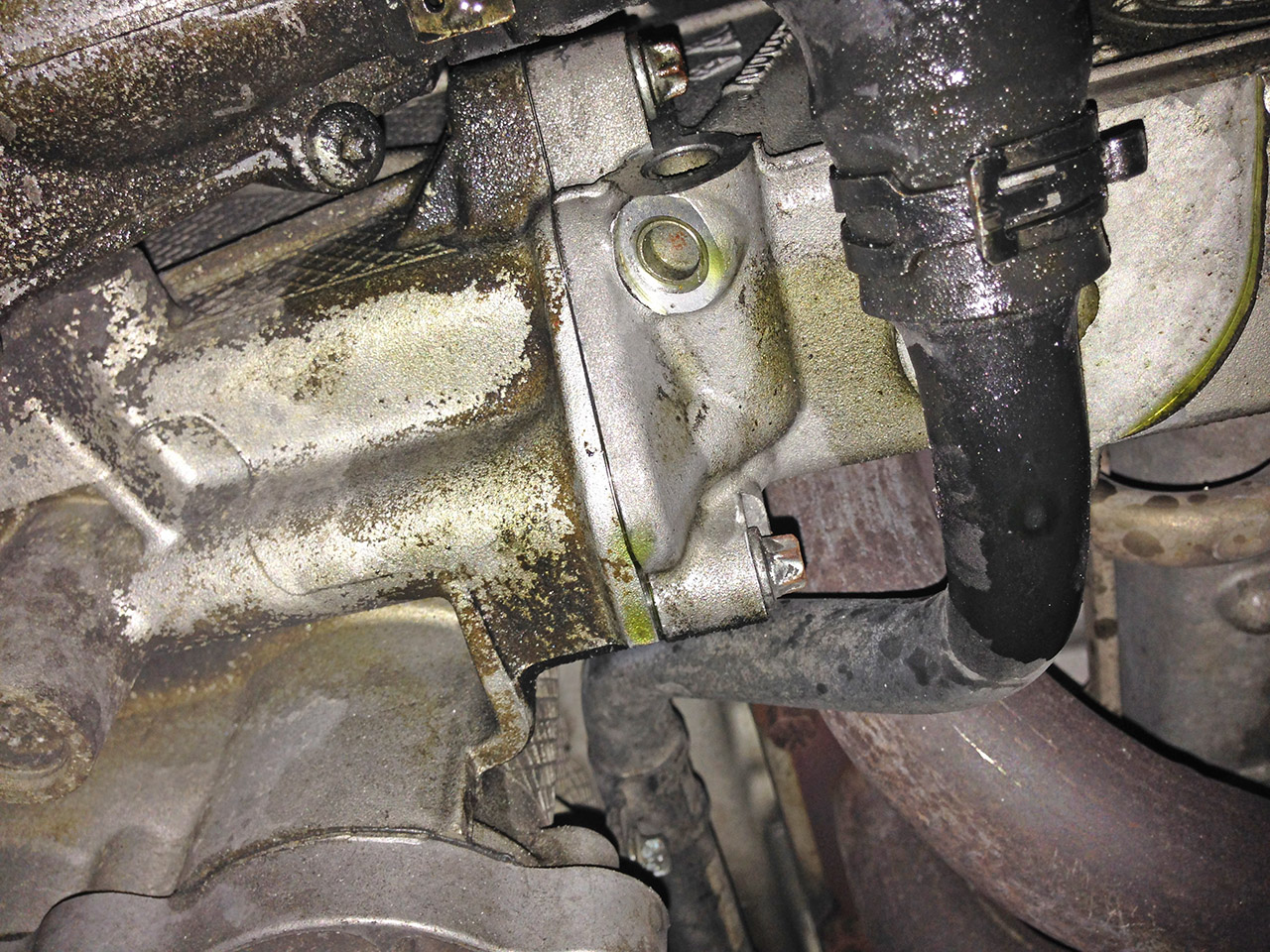

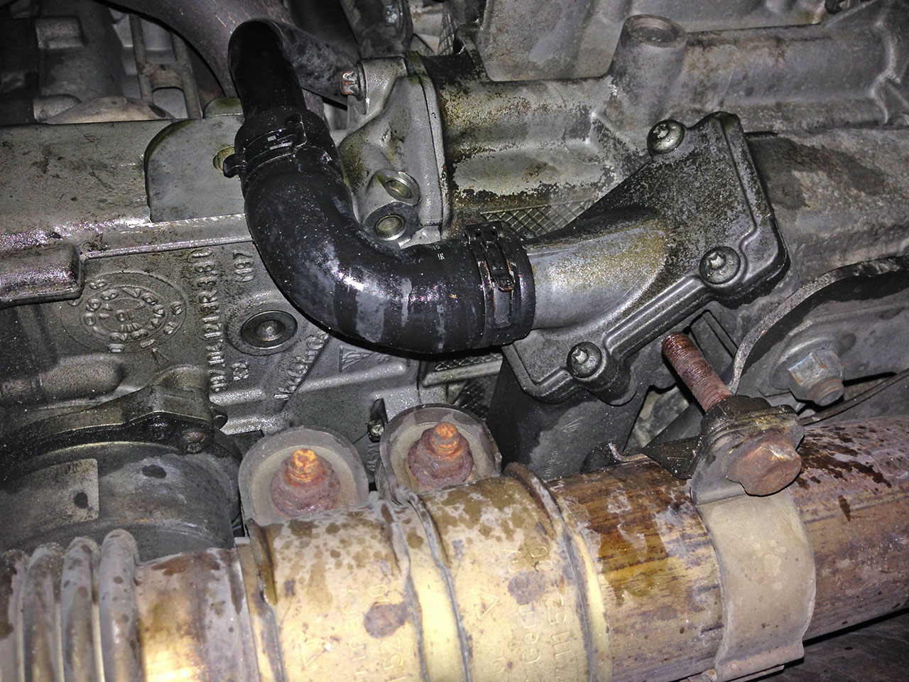

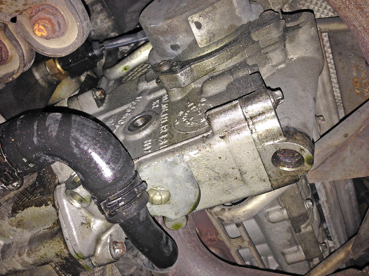

997.1s, leaking a few drops every night, very slow, brown-oily texture, few inches to the side of the right (passenger) rear wheel.
I snapped few pictures from below the car, without raising it (attached, all pictures looking from ground up).
I added engine oil (one quart). The level of the power steering fluid is low, I have not added Pentosin yet.
Any idea where that leak could have originated from? Where next should I look before taking it to my preferred workshop?
Thanks in advance

Assuming the coolant in your car is yellow (and not pink/orange), it looks like coolant to me... and it looks like it's coming from above where you're looking. You can see it pooling up on the coolant hard line in the top of the first pic.
Oil would be much darker. I haven't had a Pentosin hydraulic fluid leak since my old Audi 5000, so I can't remember what that looks like.
I'd see if you can view anything from the top looking down.
Marco,
Thank you for looking and taking the time to answer!
Quick questions: assuming it is leaking coolant... do you expect the leaked liquid to have some oily property when touched (very liquid, but slippery) ?
I will check the color of the coolant. I thought the coolant was topped off: could it be that it was overfilled, and on a very hot day like yesterday, it expanded and burst a joint/pipe ?

If the masses are saying Penotin/PS Fluid, I'd go with that, especially if it isn't detecting the level. I would have assumed the 997 would have the better "Pink" coolant, but I've never looked. Both fluid can be slimy, but PS fluid more so than coolant.
Assuming it is PS fluid, start at the pump and work your way out from there. It's clearly originating in the engine bay, so I wouldn't worry about the steering rack up front. Check the lines coming off the pump first and follow the wetness to the highest/originating point.

What color is your coolant? If it is pink then you can rule that out. Coolant also has quite a distinct smell. Looks very much like old Pentosin to me. The PS pump is on the top of the motor just slightly off center to the passenger side. Should be easy to see if there are leaks around it.

I checked the Pentosin pump: no visible leaks around the pump or the pump cover. Looking down, it was difficult to see: very crowded real estate there!
On a white paper towel, the liquid appeared almost transparent, i couldnot spot any coloring. I scotched under the car a matrix of white papers (printer paper) to pin point the leak, and report on the color.
That said, looking from under the car upward, there are traces of black greasy residue on some parts, feels like grease that has been there for a century or more...

I scotch-taped white printer paper under the car, and left it overnight. In the morning, on the paper, a single drop about one inch diameter, oily, no color tint at all.
With the iPhone camera pointing upward, flash on, I snapped a picture (see below). Then I touched the accumulated green drops:
. very smooth, with the viscosity of water
. leaves on the skin a very mild oily sensation
. No color tint when on the skin
. No smell at all
Felt like a diluted mix of oil. I will wash this area as suggested this afternoon, then fill Pentosin tomorrow afternoon, and drive it a couple of miles, per the suggestion above.
