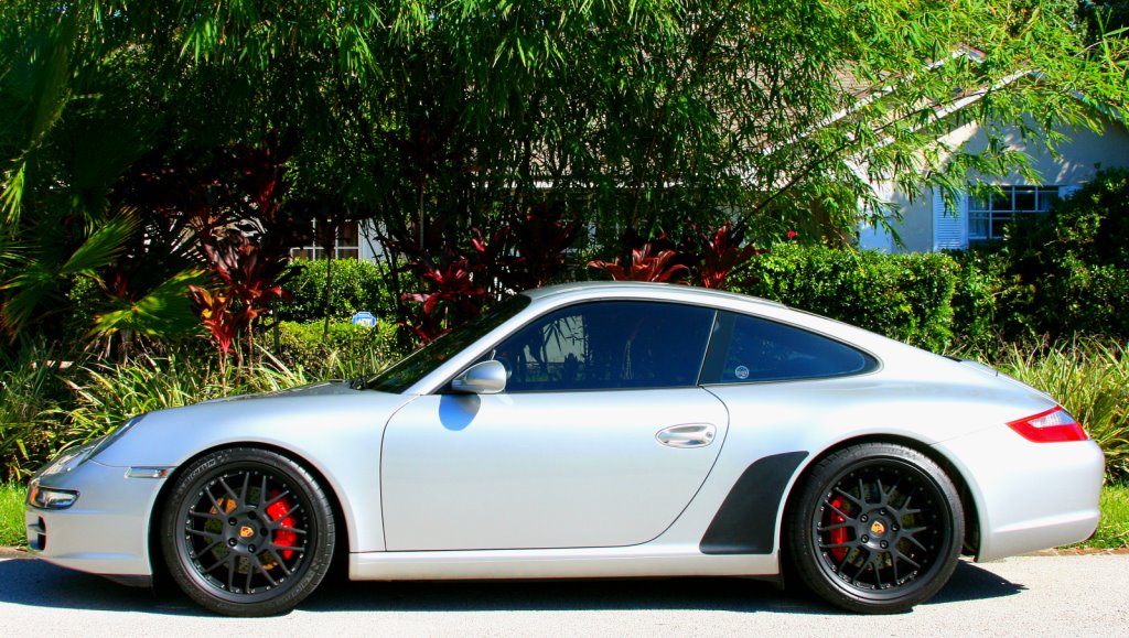

Took a side profile my 05 C2S with Eibachs to show the height:

That profile shot looks great. Very clearly illustrates the drop, thanks!
