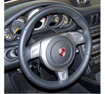

Semicycler - not true...
see the attached photo's
I have the round sports wheel WITH tiptronic buttons, I was hoping i could just swap the buttons and circuit board into the non tiptronic sports wheel..
(stole the photo from another thread)
Old Oct 1, 2014 | 01:48 PM
semicycler's Avatar
Joined: Jun 2012
Posts: 686
From: Chicago
Rep Power: 69
semicycler has a reputation beyond reputesemicycler has a reputation beyond reputesemicycler has a reputation beyond reputesemicycler has a reputation beyond reputesemicycler has a reputation beyond reputesemicycler has a reputation beyond reputesemicycler has a reputation beyond reputesemicycler has a reputation beyond reputesemicycler has a reputation beyond reputesemicycler has a reputation beyond reputesemicycler has a reputation beyond repute
My bad, I'm confusing tiptronic with multi-function. Yes the round airbag sport wheel comes in both manual and tiptronic. BUT - neither version supports multi-function PCM controls. Your question is about the tiptronic portion only, not multi-function. I think the tiptronic buttons should swap over without a problem. Just be sure to move the tiptronic wiring harness too.

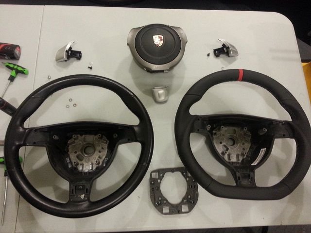

Not sure on the 991 to 997.1 steering wheel swap. But another option to consider is DCT Motor Sports: http://www.dctms.com/product_ST_PCH_997_987.html
They custom build you a new one and ship it to you. You swap over your airbag & trim pieces. Then ship your old core back to them. Many options exist including color, flat bottom, thicker, perf leather, carbon fiber, alcantara, molded sides, colored trim ring on top, etc.
Here's mine during the swap over. I've since had the airbag trim paint matched to the galvano silver sides by Eric @ bumperplugs
