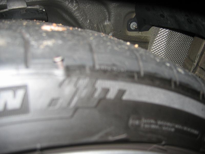

nail in tire - advice
I just found a nail in my bacj tire. It's almost in the side wall. I wasn't planning on buying new tires until the spring. Can this be plugged? I don't want some Goodyear tech school 17 year old working in my car. Should I go to a dealer? I have never had a flat or damaged tire in any car I have ever owned, so sorry for the dumb questions.

How many miles on it? Where is the nail and how close to that edge?
Most folks will tell you not only buy the tire, but buy TWO tires - yep...you want even tread on both sides. It sucks, but you'll get used to it.
You can plug some tires (yeah, I'm the Plug Guy, you know)....it reduces the speed rating one notch, and you can't do track events with plugged tires, and it's not highly recommended.

Anyhow, if the nail is within an inch or so of the shoulder, it probaly isn't sticking through the steel belts that make up the tread cap. And you really can't plug a tire through just the rubber - there just isn't anything there to hold the plug in but the glue, which isn't enough. Can you include a pic of the location? If you choose to try, and the nail isn't wider than 1/4", have the tire dismounted and a "mushroom", or "cap plug installed from the inside. May work, may not..... But if you push the car at all (anything more than average driving), I'd replace it to be safe. If you are down more than 25-30% of the tread, buy two.

Damon:
I sent you an email with a pic to damon@tirerack.com

Be safe, get a couple of new tires. It sounds like you need to replace the tires soon anyways. If you plug the tire and get even 1000 miles out of it, you are only saving 1/15 the price of a new tire or $20 per tire. A tire plug will cost $10-20 so your net savings for 2 tires in additional tread life is only $20 and that's assuming you will get another 1000 miles out of them. Look at it this way. If you got 14k miles out of the rears, you did 5k better than me on my old 996 cab. Don't even think about it... just do it for safety's sake.

One thing people tend top forget with a nail in the tire is the nail may not have penetrated into the air chamber. Pull the nail partially out and if you don't get a rush of air, you're home free. If you do, push the nail back in and follow Damons advice regarding the plug/patch.

Sorry Joe, this absolutely cannot be saved. It's too close to the shoulder. It has to be replaced.

Yep, she's a goner.

Tire plugs will NOT hold when the sidewall gets nailed! I would try it on other cars, but not a performance car. Be safe.

like others have said, i would get 2 new tires now to be safe. plugs can be used for some tires but a patch from the inside is better. i wouldnt do either on this type or tire though.

Way to close to the sidewall, shes done.
