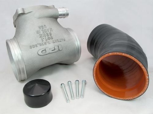

Thanks guys. I am thinking either just get an Aerokit decklid and not modify the airbox, or keep the GT3 air box and get the IPD/GT3 TB/GT3 MAS hose plus whatever silicon hoses to hook them up. The cost is similar either way.

Is the GT3 air box necessary when going with a GT3 throttle body? My wing is Aerokit, not GT3. I bypassed the Helmholtz resonator, but my intake is otherwise stock. I've been toying with the idea of a new plenum/TB, but don't want to open a can of worms.

I don't think it's required to have a GT3 airbox to go with the GT3 TB. I believe IPD provides a reducer hose as part of their competition plenum kit so you can reuse the standard C2S airbox.
See the attached photo. You can double check with IPD or one of their dealers.

Thanks, wchai. I already have that hose. It was the best $20 I ever spent on my car. The throaty intake sound alone is killer. I can only imagine it accompanied by a few more hp.
