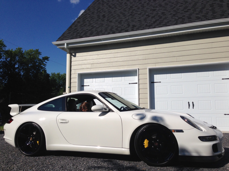

on 20" too. Mine vibrated alot before I added centering ring in back of wheel. Still vibrates a bit but front tires have flat spots
mk3boy, car look awesome, would like see more pictures. I have a set of vossen CV3 20" but have not put on yet.

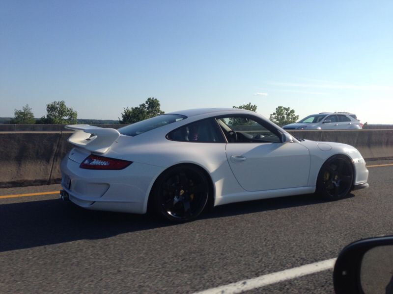

pic2

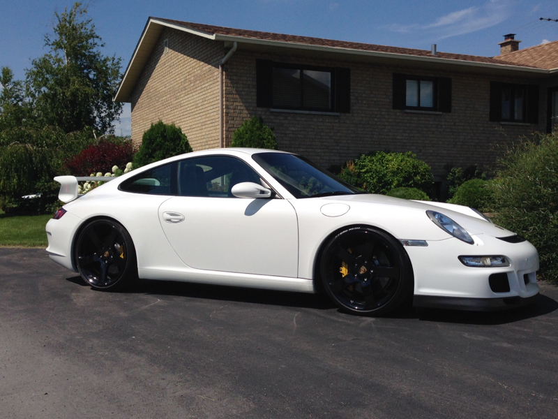

pic3

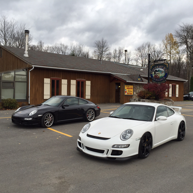

pic4. sorry phone messed up

Looks great mk3boy, are you on lowering springs or coilovers? The ride height looks perfect on 20s

bilstein dantronics cranked way down... maybe 2-3 threads or barely left. It scrapes less in front on the 20" lowered then stock on 19"
