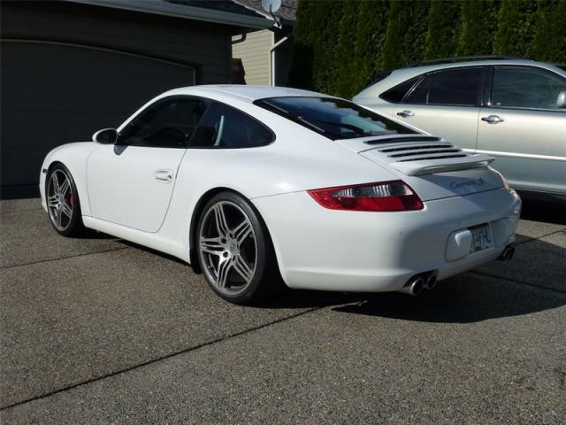

I have the Bilstein Damptronic Coilovers. Pros: Can adjust ride height exactly how where you want it; compatible with PASM. Cons: ride is firmer than stock and likely firmer than on lowering springs; expensive.
**In normal mode the ride is firm but not bone-jarring (on Sport I would call it bone-jarring....). The upside to the firmness is you can go low without scraping (and the car handles like a go kart!). My car is pretty low and even with aggressive spacers I experience zero tire rub and do not bottom out on anything. The only scrapes come from steep driveways. I attribute this to minimal spring travel and the fact that the springs reset so quickly after dips, etc. Whereas lowering springs can have more of a bounce effect (at least on other vehicles I have owned).
