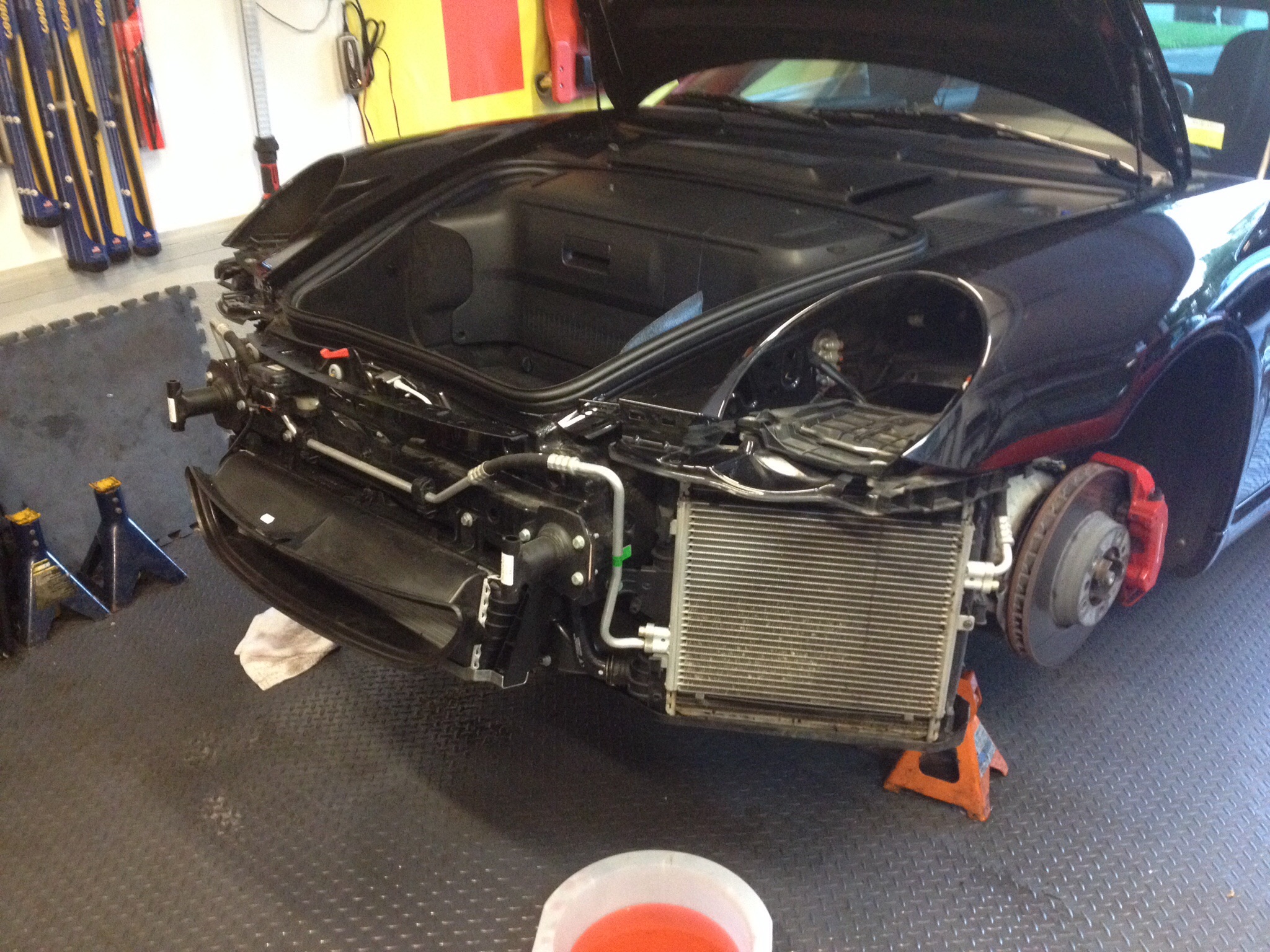

When you install the center radiator there is a duct that forces the air out of holes that you cut out of the bottom of the bumper. The GT3 uses the vent in the top of the bumper to do the same thing. You can't see it here but behind the radiator a plastic shroud funnels the air down.
