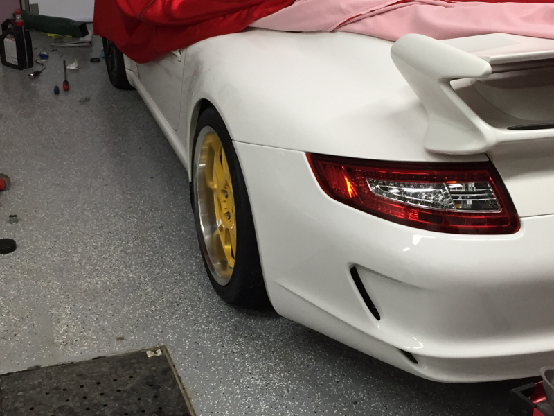

315 on 12" wide 19" wheel. I'm going to put 305
Old Mar 30, 2015 | 03:02 PM
mk3boy's Avatar
Joined: Apr 2013
Posts: 279
From: Montreal
mk3boy is just really nicemk3boy is just really nicemk3boy is just really nicemk3boy is just really nice
pics

fenders are already rolled in the back stock . 315 might fit if you aren t lowered. Many on here run 315. Its hard to roll without cracking paint

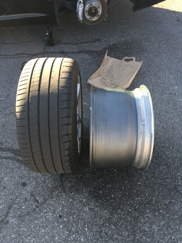

the overal width is 12.5 the inside is 11.5 when i measure the backspacing i used the overal width
stock 10" 18s vs new 19s

You measure width from the inside, not the outside.
Your wheels are likely 8.5 and 11.5, which makes perfect sense. Forget everything that was previously posted.
Look at the pic in this article and remeasure the width.
http://www.tirerack.com/wheels/tech/...e-d2ea1b3581d1
Confirm the measurements and then proper advice can be given.
8.5 and 11.5 are standard widths, and youll likely have no problems fitting them on your car.
