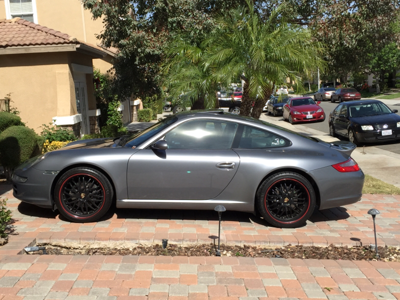

What do you guys think?
Soon I'll be looking for some front downforce as well.

I like it of all the wings out there this is my favorite look. Which brand did you go with and how was the installation and fitment?
Looks like a Misha Designs

I honestly couldn't tell you the brand, though Misha sounds familiar.
I bought it from a friend who owns the same color and year 4S. He recently upgraded from this to the one-piece ducktail/deck lid from Porsche.
The figment was great. Had to do a little modification to the deck lid hinge-deck lid mounting holes so that I could let the ducktail sit flush with the B pillars without touching the bit behind the center brake light on closing. Then it was just a matter of adjusting the tail light fixtures to be flush with the new deck lid position. (not done yet in the photos)
But all that trouble was just to let the slightly raised new wing sit flush. The fitment of the wing itself to the deck lid was nearly perfect.
Biggest pita was the removal of the original spoiler and motor. Just a lot of chances to drop screws.
In hindsight, I would recommend draping a packing blanket over the motor to catch those things, rather than scraping knuckles retrieving mounting screws that fell down near the water pump

Nice. I like this Misha's ducktail with original bodykit. It's subtle and doesn't affect the visual balance with the front of the car.

The one on your car now is probably by Misha Design; and if the "one-piece ducktail/deck lid" that your friend is really from Porsche, it is the duck tail for the "Sports Classic" 997. But it is a special limited edition 997 and would be extremely rare to find it's original ducktail in the used parts market. Getty Design makes a ducktail that looks exactly like the "Sports Classic"
By the way, did you have to go to the dealer to disable the auto-up/down feature for the rear spoiler?

Not yet... But I need to get that done, along with disabling my most recent "service due" message. (I do all my own maintenance.)

Looks great. You were really lucky to be able to add a great looking wing that was already your color. I just got off another active thread here about adding an aero wing (which I have). You will likely need a new wiring harness to avoid errors every time your old third brake light wants to come on. This is in addition to the PIWIS reprogram. I bought one at Auto Atlanta for about $80. It's a very simple DIY install.

I actually got a new wiring harness with the wing, so now all that's left is the PIWIS setting. Any thoughts on something for front-end downforce?
