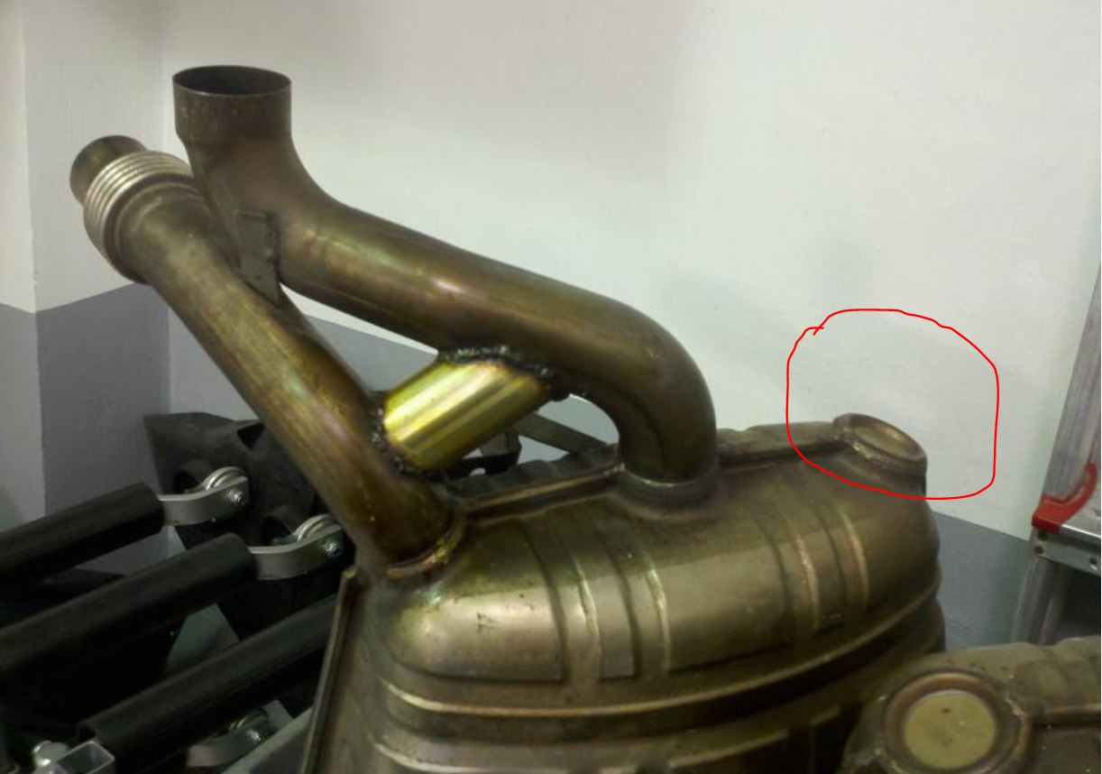

A friend had the gundo mod done on his carrera 3.6 and it sounded great. Once I got my C2S I got the gundo mod done, even by the same guy.
Problem is the sound is really raspy/kinda ricey during normal driving and regular acceleration. Especially around 3-4k rpm or part throttle.
It sounds great when your revving it out fully and near redline. But the rest of the time its not that great
Car has only 18K on it. We used 2" pipe for the gundo hack (same size used on the friends car that sounded great). I have checked the car for leaks or cracks on anything and everything is good.
Anyone have any ideas as to why? is the pipe size too big? Does the 3.8 sound that much different than the 3.6?
Here are some pics of the work, he does really nice work.

1. First photo:
I was not happy with the pipe to pipe hack (a bit too loud, raspy, ricey)
2. Second photo:
I was happy with the muffler to pipe hack "More my age sound"
(most muffler shops can do this trick)
I think the sport exhaust taps into the muffler (knock out plug) it does not connect the two pipes.
Vrooom

Originally Posted by h1sp
1. First photo:
2. Second photo:
Vrooom
This is just the kind of info I was looking for, I think I will give the muffler to pipe hack next. Yes, it would be like having the PSE on all the time basically. That would be good for me.
Thanks for the info, much appreciated

You may want to go for a refined sound by tapping directly from the exhaust can the same way the factory PSE is tapped. See h1sp's picture on page 1.
Instead of hacking directly from the exhaust inlet (which gives a partial straight pipe effect), you can hack into the exhaust can where the exhaust flow has been a bit more "processed"- for lack of better terms. There's a blocked off port specifically for this.
