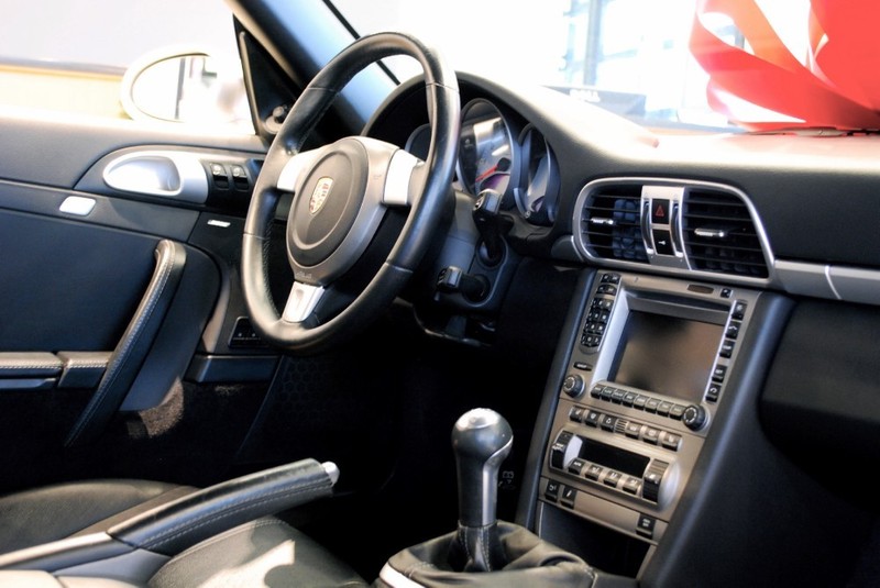

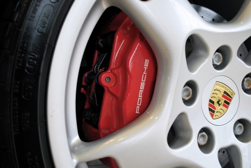

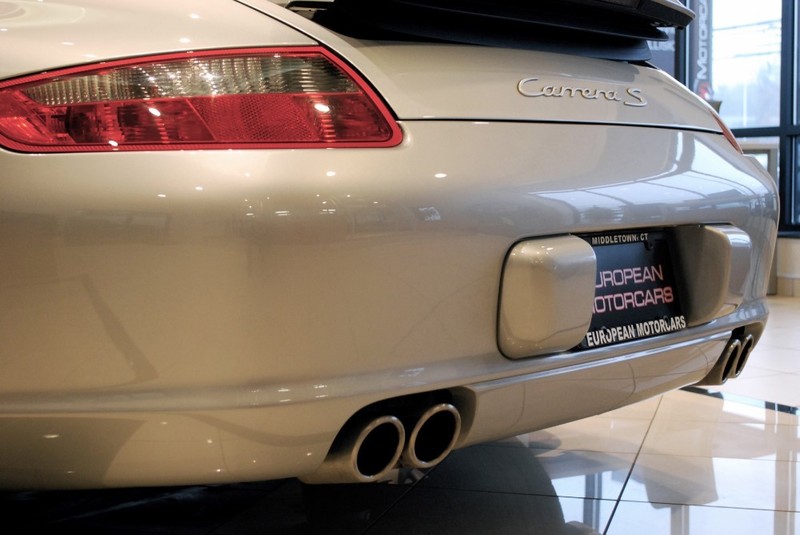

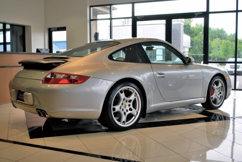

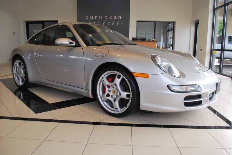

Pics of my car for reference (still haven't taken my own pictures yet):
