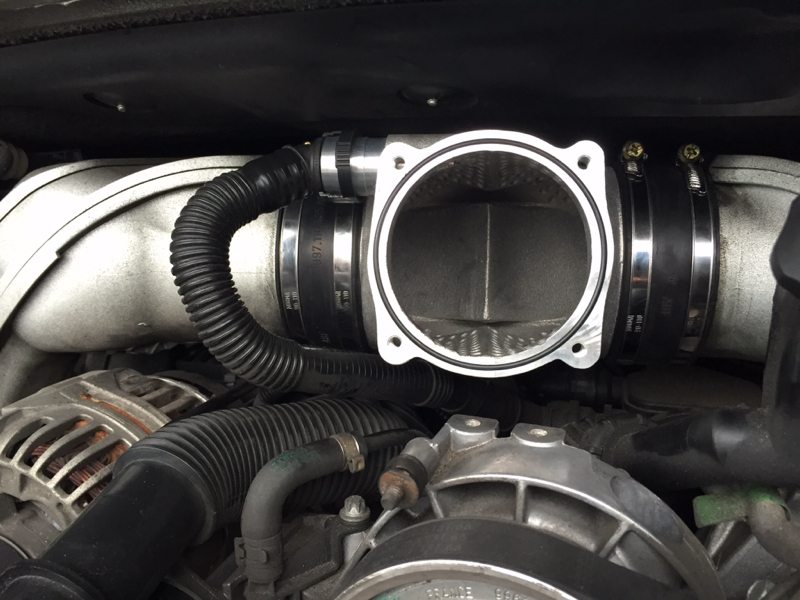

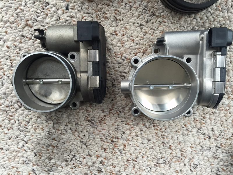

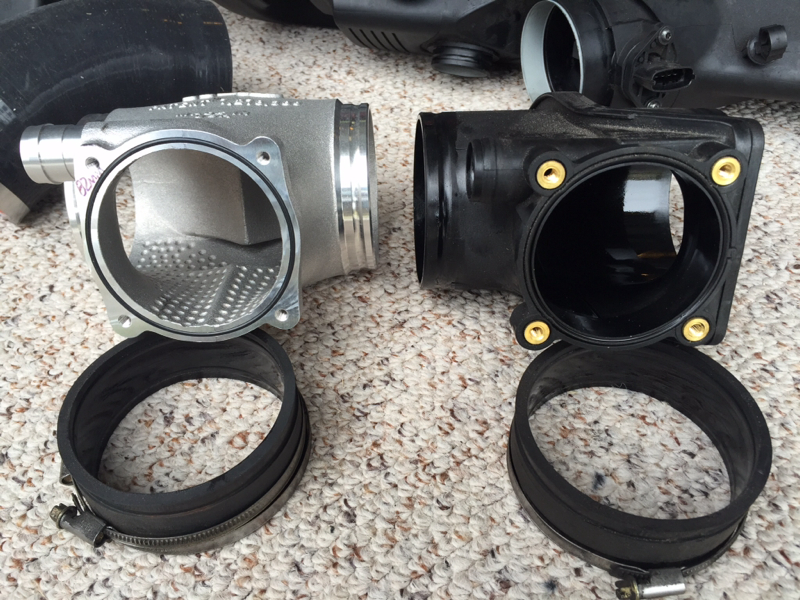

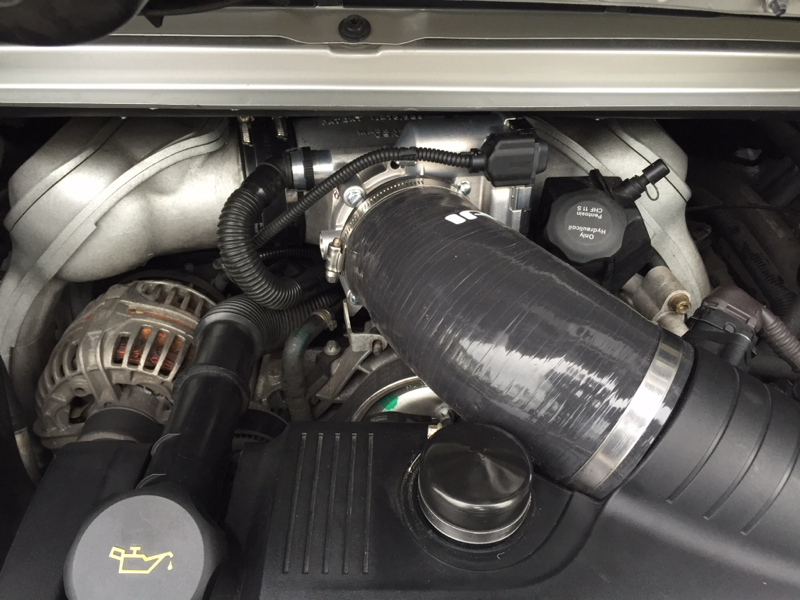

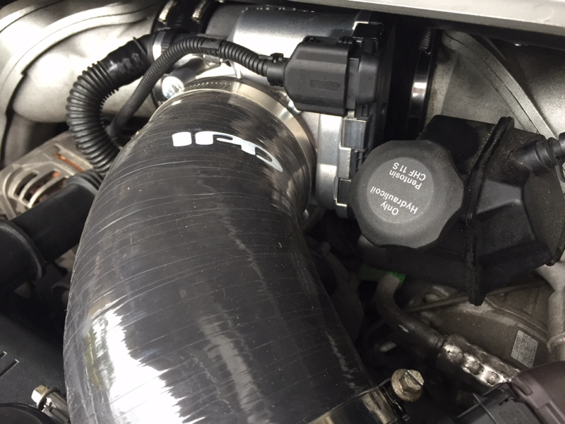

IPD Plenum GT3 Plenum & Throttle Body
Bolt on power in an hour
Added drop in a BMC air filter, and WOW... Next step EVOM ECU tune and I'll be set.

Did you have challenges with IPD's silicone tube? I had a difficult time fitting it.
Old Jun 4, 2015 | 06:58 AM
mk3boy's Avatar
Joined: Apr 2013
Posts: 279
From: Montreal
mk3boy is just really nicemk3boy is just really nicemk3boy is just really nicemk3boy is just really nice
yes it was challenging to figure out if it was on right. Had to turn tb on a angle also. This along with rss engine mounts, numeric cables and evoms intake...
Old Jun 4, 2015 | 07:24 AM
Gary B's Avatar
Joined: Feb 2013
Posts: 129
From: Tampa Florida
Gary B has a spectacular aura aboutGary B has a spectacular aura about
Don - I gave each side a shot of silicon spray, they went on in less than five minutes. The entire project took less than an hour start to finish. There is a noticeable increase in power between 4,200 and 6,500 RPMs. I have to tweak the tune to fill in the gap on the low end power. I should have don this a longtime ago.
When I did mine it seemed like the hose they provided was nearly a 1/2" too long.
