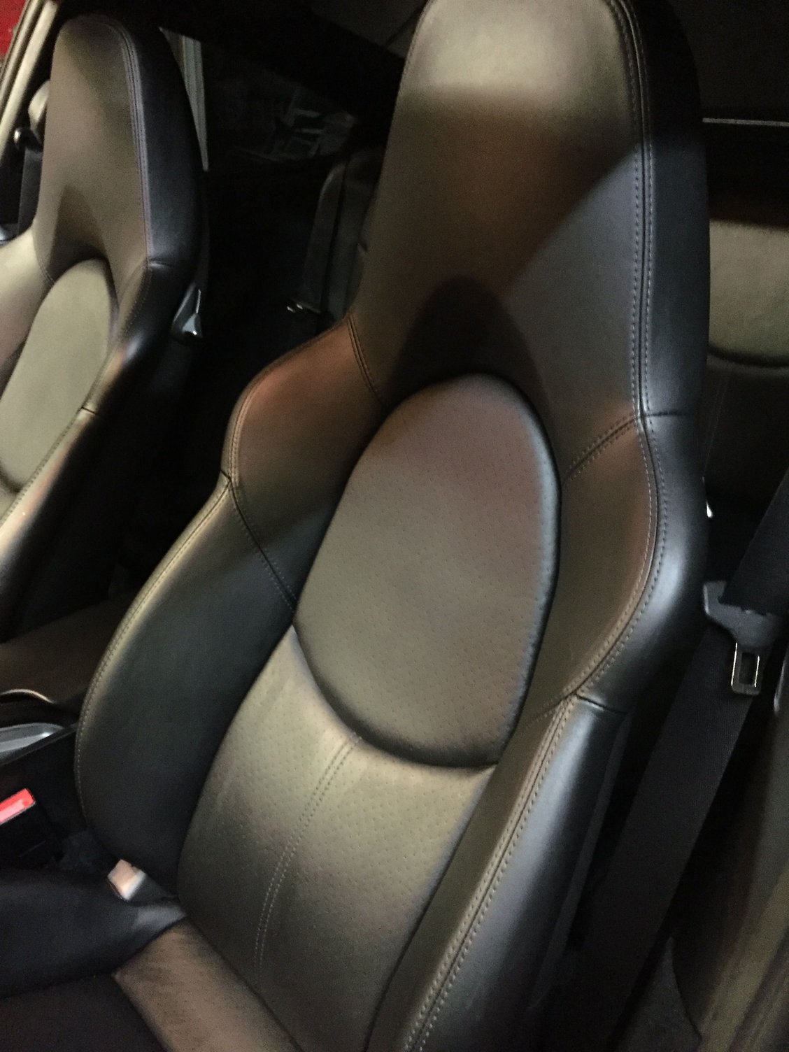

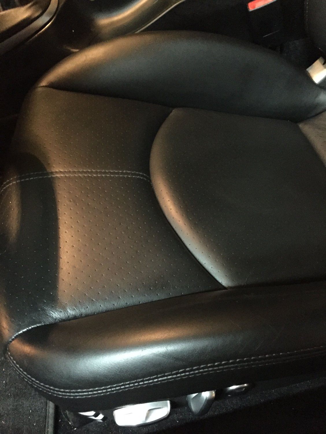

2009 C2S , 28k miles

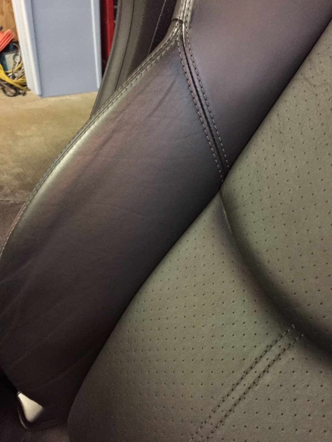

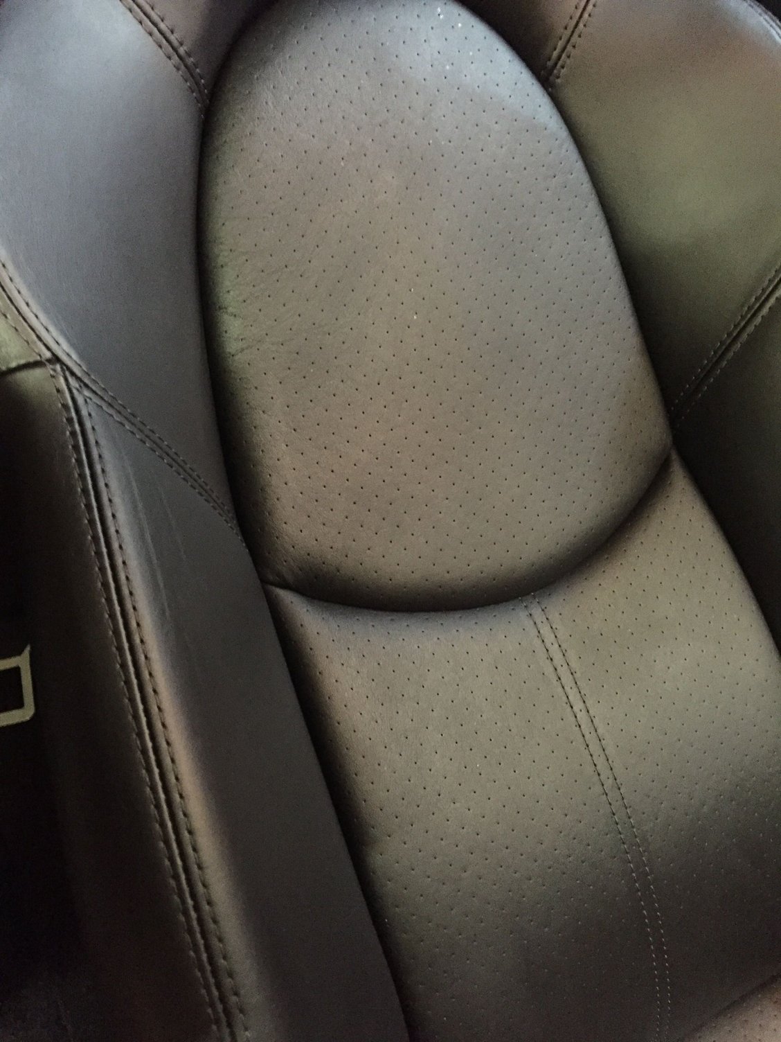

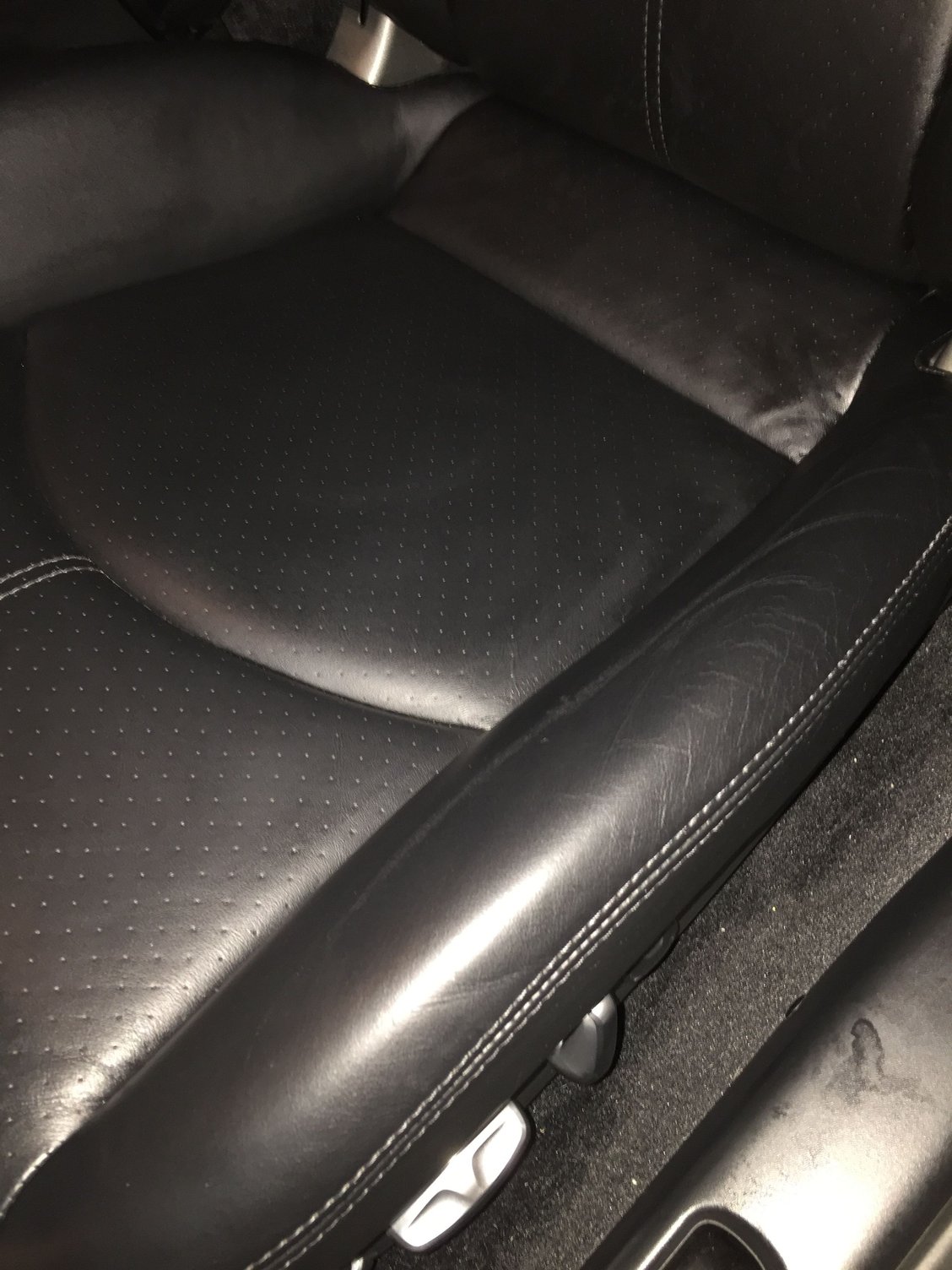

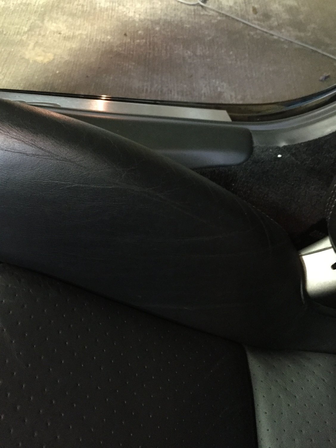

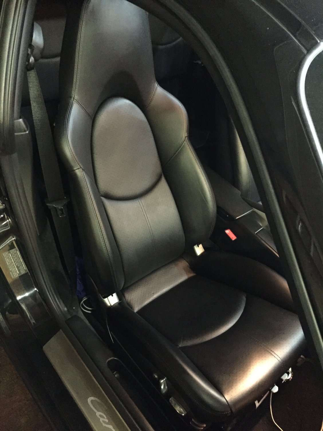

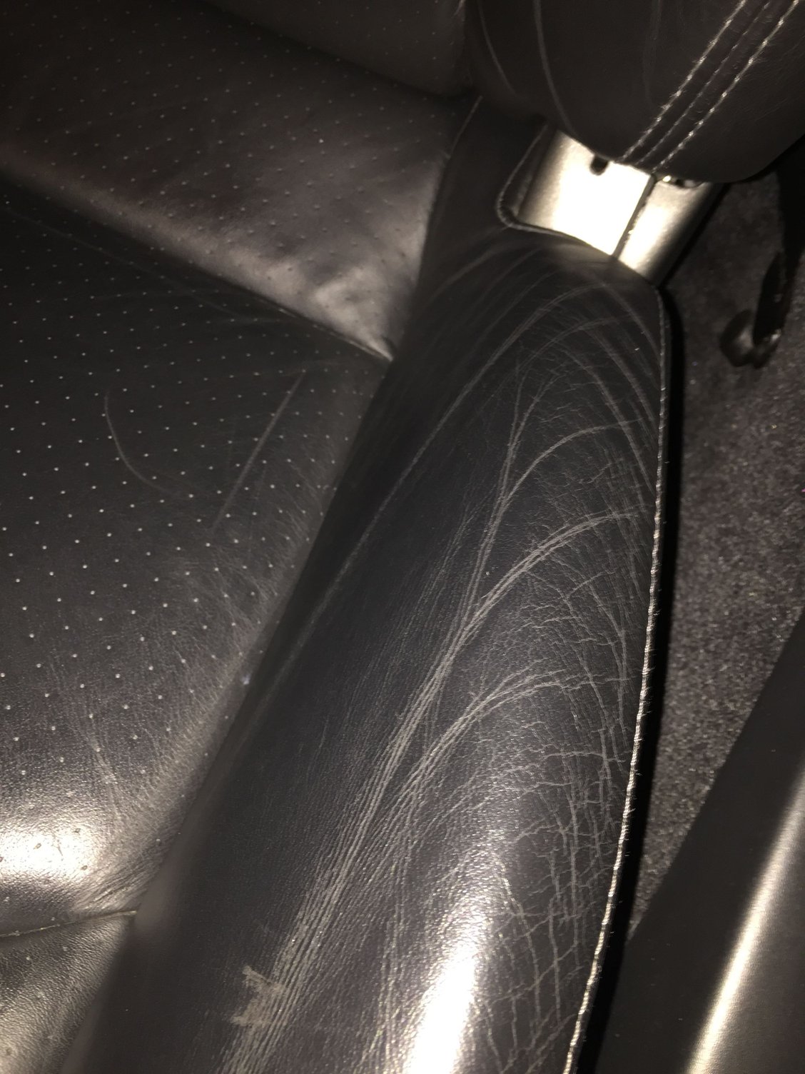

I will let the photos speak for themselves.... but I'm super impressed!
Driver Bolster
BEFORE
AFTER

Holy cow, that's remarkable!
So, was this the rejuvenator oil followed by the prestine clean treatment? Can you tell us how you did it?
Old Sep 19, 2015 | 05:52 PM
NYC997's Avatar
Joined: May 2013
Posts: 60
NYC997 has a spectacular aura aboutNYC997 has a spectacular aura about
It was a piece of cake... I used a foam pad to coat the entire seat in a generous amount of Rejuvenator Oil , let it sit with heat on in garage for about an hour ... pulled car out the following morning and applied some more oil to the real trouble spots.... and let it bake in the sun.
That night i just used the cleaner in a spray bottle and a microfiber rag to wipe it down... and presto! Came off so easy once the cleaner hit it.... the results are remarkable
I picked up the 8oz Starter kit from AutoGeek.net and this entire thing cost me about $40
