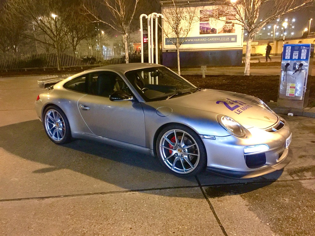

Porsche 997 with 991 wheels
Ok ok nuff with the he said she said...... You can fit 991 20' wheels on a 997 the ride comfort will improve, there is no difference in the rubber profile from a 19' wheel, fronts 35' rears 30' and on a 20' wheels, fronts 35' rears 30' profile, only the rims are bigger from 19' to 20 inches, now, I think the ride is better because I believe the tire walls are stiffer as I have noticed a more comfortable damping feel on bumps and potholes, so an improvement to the 19s rubber, there are some right fools out there 'about the ride will suffer, where do these people come from with their opinions' do your homework then make a valuable opinion, so others can be informed.... Ask any 991 driver if the ride in harsh and I don't think Porsche would make it next gen 911 a worst and uncomfortable ride do you ....
Now, as for 18' for track I can't see the logic in this but that's another bag of weed to smoke haha I don't smoke ... Moving on ,,,
so you are thinking of going BIG, good boy or girl, here the pros and cons if you get the right offset wheels anything is possible I have a slim body 997 Carrera S running 991 20' wheels ,,, rubber boots 245-35-20 rims 8.5j / 20' offset 51' that the front; now the only problem with the front are the 245 tires with the standard Spring support touch, so to get out of jail, you would need to replace the tires to the 997 standard 235 tire 35-20 to stop the rubbing or add a 5mm spacer at front but this pushes the rubbers out pass the arches this will effect cornering speeds,,,,
the best solution would be to upgrade your suspension support to coilovers springs and it's a win win situation all the way to the bank, you can keep the 245 rubbers without spacers giving you a wider track at stock heights or you have the option to lower your car and the car will look slam, get all the wheels aligned and they will be no rubbing.... My 991 rears rubbers are 295-30-20 rims 11j / 20 offset 52' nothing to say here they fit no spacers required but you know, there room for a 21' rims here, 991 GT3RS anyone hmmmmm ......
P.s.....Porsche wouldn't give the 991 GT3RS MONSTER 20' front and 21'at the rears for track days 'IF' 18' wheels was the only option for track Manoeuvring, you may as well add skateboard kryptonic wheels to your Porsche the RED ONES not the Green or blue MMMMMM
