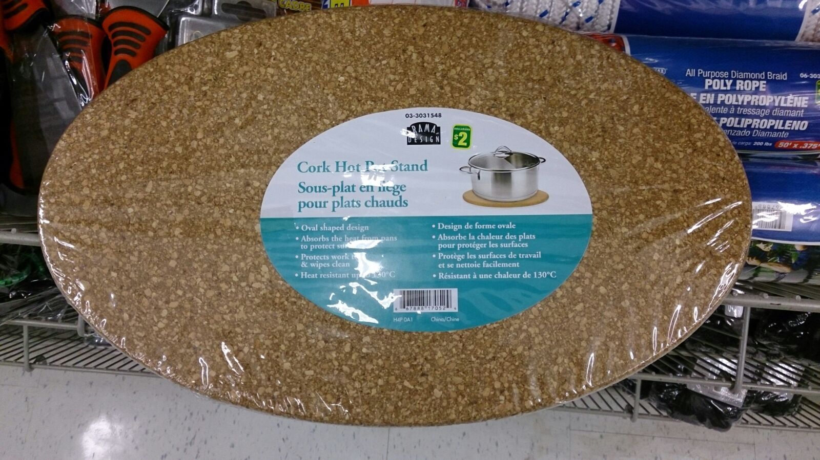

So I found these cork pad ($2 each) at a dollar store and thinking what can I do with them. They measured 14" x 9"
Then, hummm........
I can put them under my tires for storing my 997 on my lift during the winter months. It's a perfect fit
Total cost $8
Then, hummm........
Total cost $8
why ?

You see those little (mini-football shape) fiction marks on the steel platform.....they will leave imprints on the tires and could cause the tire to make more noise...
