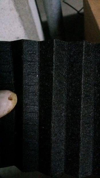

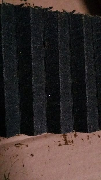

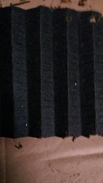

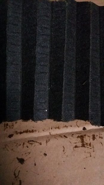

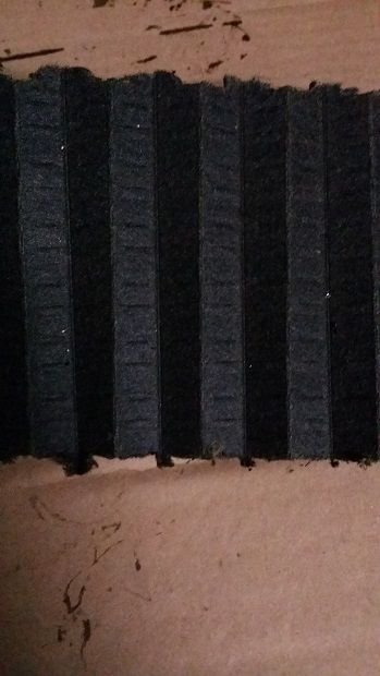

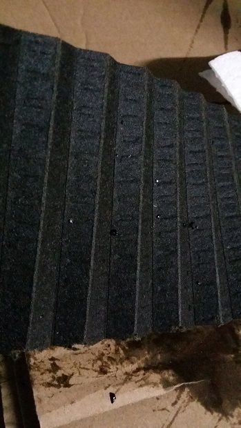

Well I need to change the title of this thread to identify the metal in my oil.
Cut open filter found metal specks. A few dozen. pretty tiny, the biggest were about 1mm wide.
Filter had been in engine for 11 months, done about 6,000 miles. It was changed a few days after a non competitive track day last year - would this suggest the reason for the flakes?
Pics. Normal? Panic?

I think I just dodged a bullet, out of every single metal flake in the filter only 1 turned out to be magnetic.
Good sign?
Good sign?
Don t know, that may just help you identify the part by type of metal. Someone with internal engine parts metal will chime in I hope.
Didn t look like a lot, hope your OK. Plus you still have that plastic substance .

I read that only magnetic flakes are a worry. That non magnetic flakes are normal & are off the engines aluminium housing. Can someone confirm?
There were tiny blobs of that plastic substance on the inside of the filter, Im fairly sure it's a sealant of some kind. There wasn't a lot of it.

When I last changed my oil on a 47K miles 2005 C2S, I had similar results in my oil filter medium. I asked some good folks at Mayo Performance to review the medium. They said that they would not worry about that level of metallic contamination. I too had mostly non-magnetic metal. They suggested that at the next oil change (they recommend more frequent changes then the factory) I clean the internal oil sump area so that at the next oil change any new contamination is likely to be attributable to new activity rather than residual just "trapped" and randomly released from the sump. I have a few more months to go before dropping the sump plate.

My shop also said that amount of debris isn't cause for alarm especially if its not magnetic. The oil filter that was just pulled out was put in after a track day, that may have contributed to a few extra flakes. I've also sent some oil away for analysis I will post the report here when I get it back.
