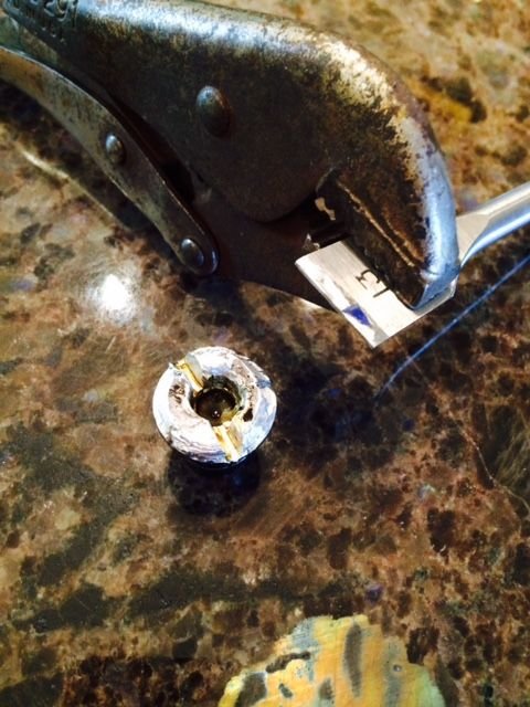

Originally Posted by StormRune
Vladm, It's not clear to me if you are saying the allen head stripped like MillerTime shows or whether the threads that mesh with the oil pan stripped. It may help to clarify.
Yes it stripped and looked just like his
Old Nov 4, 2015 | 12:56 PM
Buddhamonk's Avatar
Joined: May 2013
Posts: 390
From: PDX
Buddhamonk has a spectacular aura aboutBuddhamonk has a spectacular aura aboutBuddhamonk has a spectacular aura about
Originally Posted by Vladm
The F****r is out!
Tried Easyout- no luck.
used dremel to make a deeper notch and fabricated a wide "screwdriver" by grinding the hole bit. Locked vice grip and turned it as a lever. Bingo!
Stay the hell away from these plugs!!!!
I bet the plug would be fine if people used only 25-30 ft/lbs of torque on it
The F****r is out!
Congratulations!! Before it stripped, was it a hex fitting (8mm?) or was it a Torx fitting?

Someone told me although a 8mm works it s really a torx configuration. I ve always used a 8mm even after being advise against for this very reason... ???
Old Nov 4, 2015 | 05:42 PM
jhbrennan's Avatar
Joined: Apr 2006
Posts: 5,260
From: Austin
Rep Power: 770
I was told just the opposite - it's 8mm hex and not torx and that using torx may cause the rounding. Maybe ECS can confirm.
...and you'd lose that bet. The aluminum used for the plug is very soft and the hex slot is not deep enough to withstand the forces required to loosen and tighten the bolt plug to spec.

Main Oil Drain Plug, M18x1.5mm thread, 8mm hex bit
OEM Torque: 37 lb-ft
Magnetic Aftermarket Torque: 19 lb-ft
Thx! 8 mm.

Originally Posted by slicky rick
Confusion coming from stripped and rounded. Stripped threads rounded hole
Correct.
The hole got rounded and the 8mm hex could not get the plug out. The threads were unaffected.
Sorry for the confusion.
Similar effect and a major PIA.
I think you need to consider the possibility that not all folks recognize the difference between Torx and Hex. Using the wrong tool is the easiest way to strip any piece. Ask me how I know.
