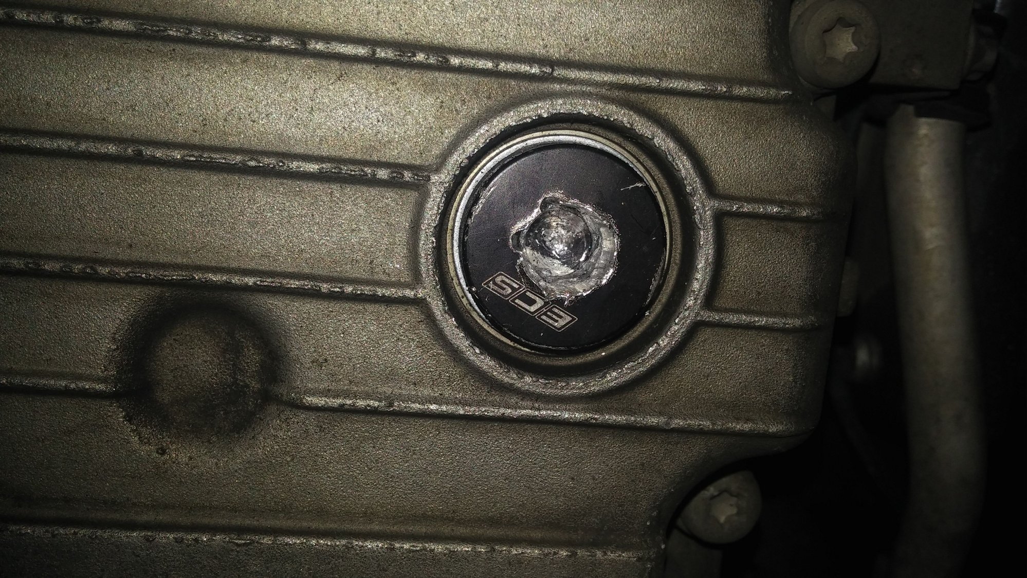

I installed the ECS magnetic oil plug about a year ago. I did about 3 oil changes since then.The last time I did the oil change the drain plug felt like it was very soft and was slipping a bit.. Didn't pay too much attention to it, torqued it back in like I always do and went my way..
Well today I was going to do the oil change before putting the car away for the winter.
The plug is so soft it stripped right a way!
Tried everything to get it out- no luck. Even tried grinding a notch, improvised a 13/16" "flat screwdriver" tool with a 1/4 driver for the cordless impact-no way.
Called ECS and asked for advice- they are clueless.
I have changed the oil on all my P cars for the last 20 years. Never had a problem. The aluminum ECS use is simply just too soft for this application.
Now what? Drop the pan? Drill the plug out?
Anyone had a similar issue? Plz help!
Thanks!!

Yeah, the ECS drain plugs are good for only 2-3 oil changes and they know this. The same thing happened to mine and I was able to grind a notch for a large flat blade screwdriver. Another option is grind or file the round edges flat on 2 sides so you can get a wrench on the outside of the drain plug. ECS should stop marketing this plug as the end all of magnetic plugs as well its not a very good drain plug alternative at all.

I tried again with a notch and an impact driver. NOT a chance.
I am LIVID! What a POS product!
I will try tomorrow with an Easyout.
Last resort-I have to take the pan off. Now that's going to fun with 8.5 quarts of oil dripping all over. GRRRRR!!

Vladm, It's not clear to me if you are saying the allen head stripped like MillerTime shows or whether the threads that mesh with the oil pan stripped. It may help to clarify.

using a dremel with small cutting disk and make a cut in the center, then use a chisel like you would use a flat head screw driver
Also you can weld a small socket to the plug itself

The F****r is out!
Tried Easyout- no luck.
used dremel to make a deeper notch and fabricated a wide "screwdriver" by grinding the hole bit. Locked vice grip and turned it as a lever. Bingo!
Stay the hell away from these plugs!!!!
