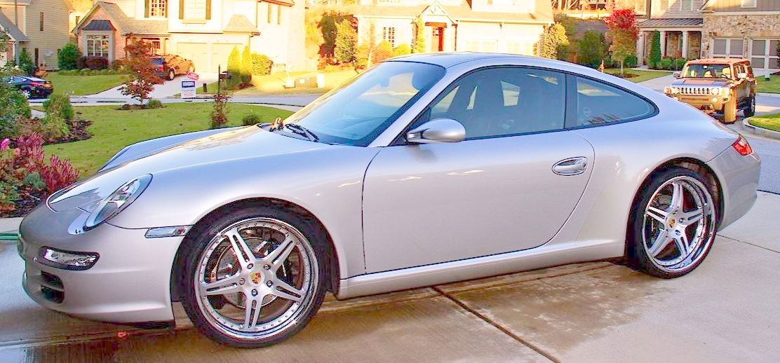

Old Mar 1, 2016 | 08:23 AM
pderover's Avatar
Joined: Jan 2012
Posts: 90
From: Atlanta
pderover is infamous around these parts
Here's a pic of my car before my aero bumper and coilovers.
