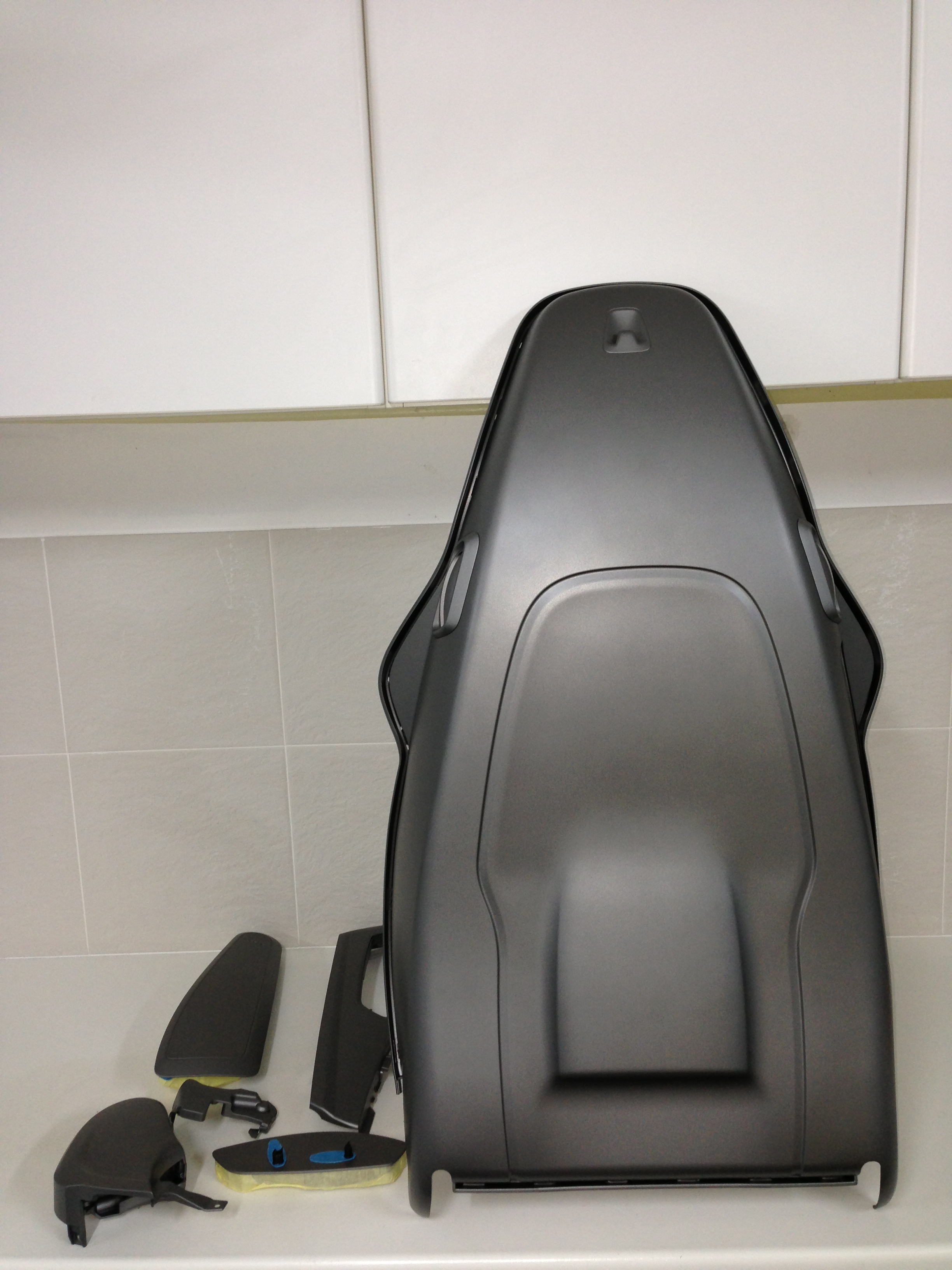

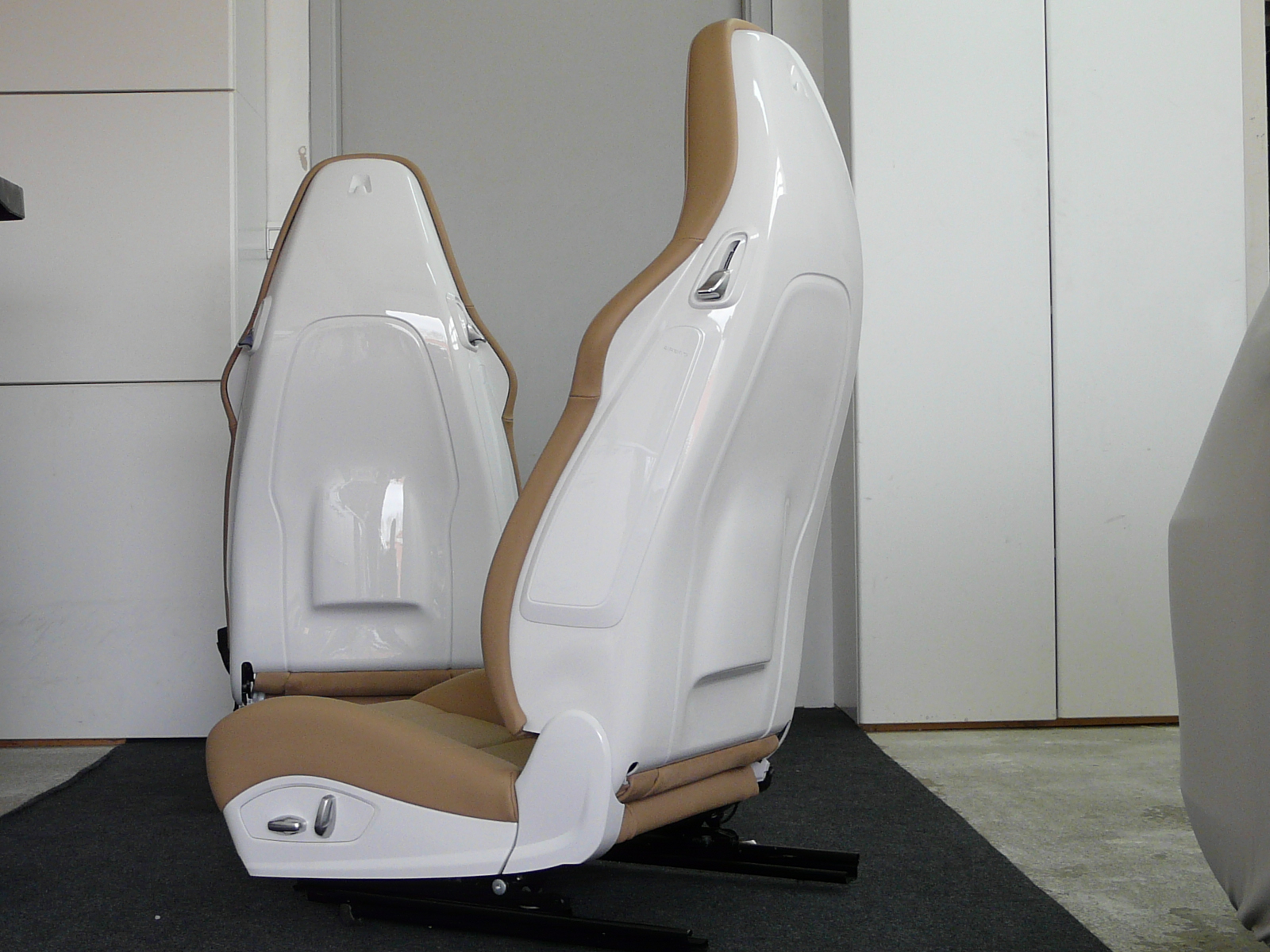

Hello Marco,
I sent to you the procedure and pictures to remove seat covers
Good luck !
Regards
Did's

Hi, I put instructions and more pictures there :
https://www.6speedonline.com/forums/...ack-panel.html
