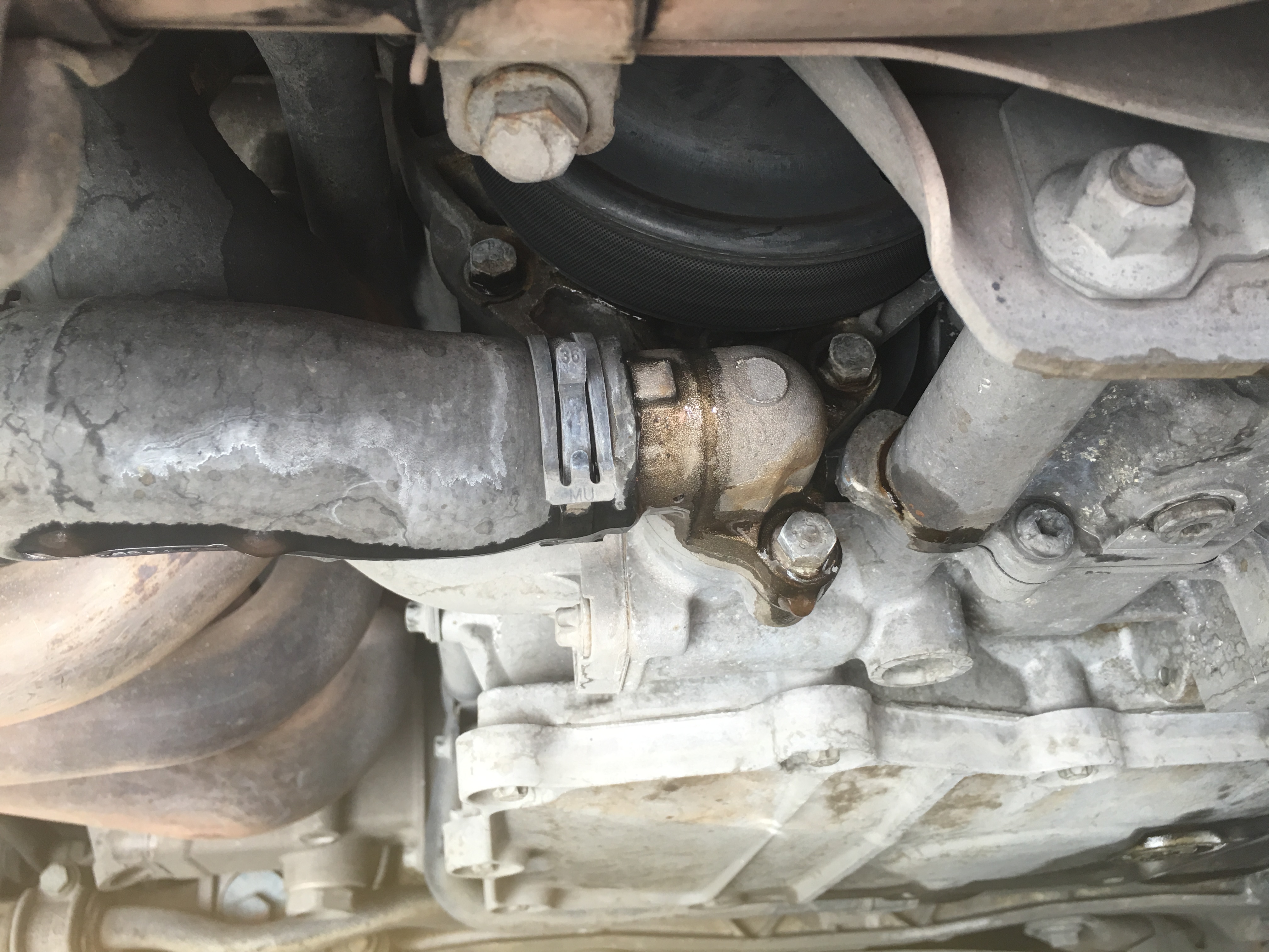

Was in the car s long time today. Car did not overheat and I stopped eventually to grab a coffee--and came out to the car dripping behind the drivers rear tire. The expansion tank is still 95+ percent full. I'm about a mile from home and wondering if I can safely drive the car home. Not wanting to risk it but there's just a steady drip coming from the water pump. Perhaps 16oz on the pavement....All signs point to no, but it's not a catastrophic leak.....

Well F it. Not overheating and it's just a drip. Got home in 5 min and I have a can under it. Needle never got past 175f. Question is do I go for a pump, seal, serpentine belt and hoses or what? No warning lights on either as to coolant loss.

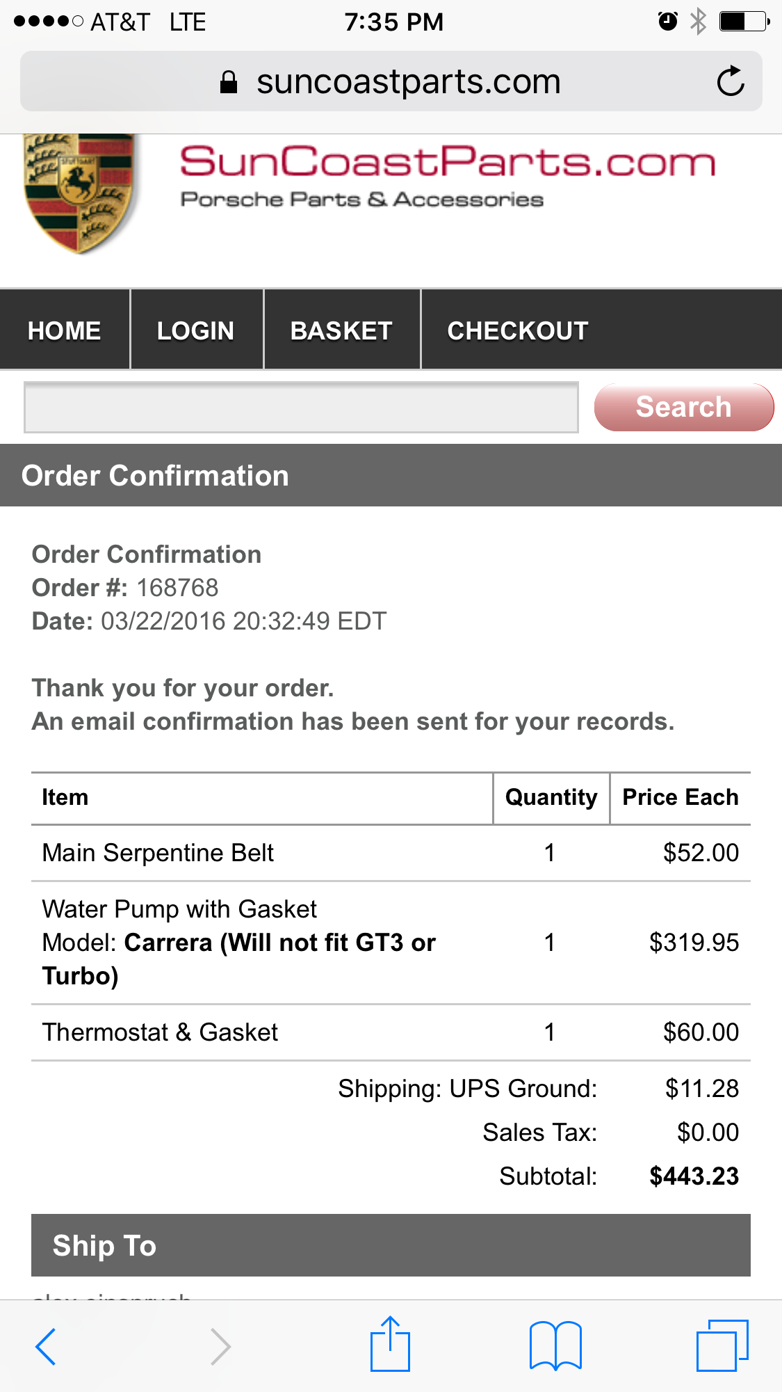

All in
Hope I didn't forget anything....

I put a catch can under the car yesterday when I got home, and it maybe dripped 2-3 tablespoons of coolant overnight. Maybe a depressurization keeps the system from leaking? Dunno.

Oddly that three part pump was HALF price at ECS. Ordered the rest from Sonnen.
