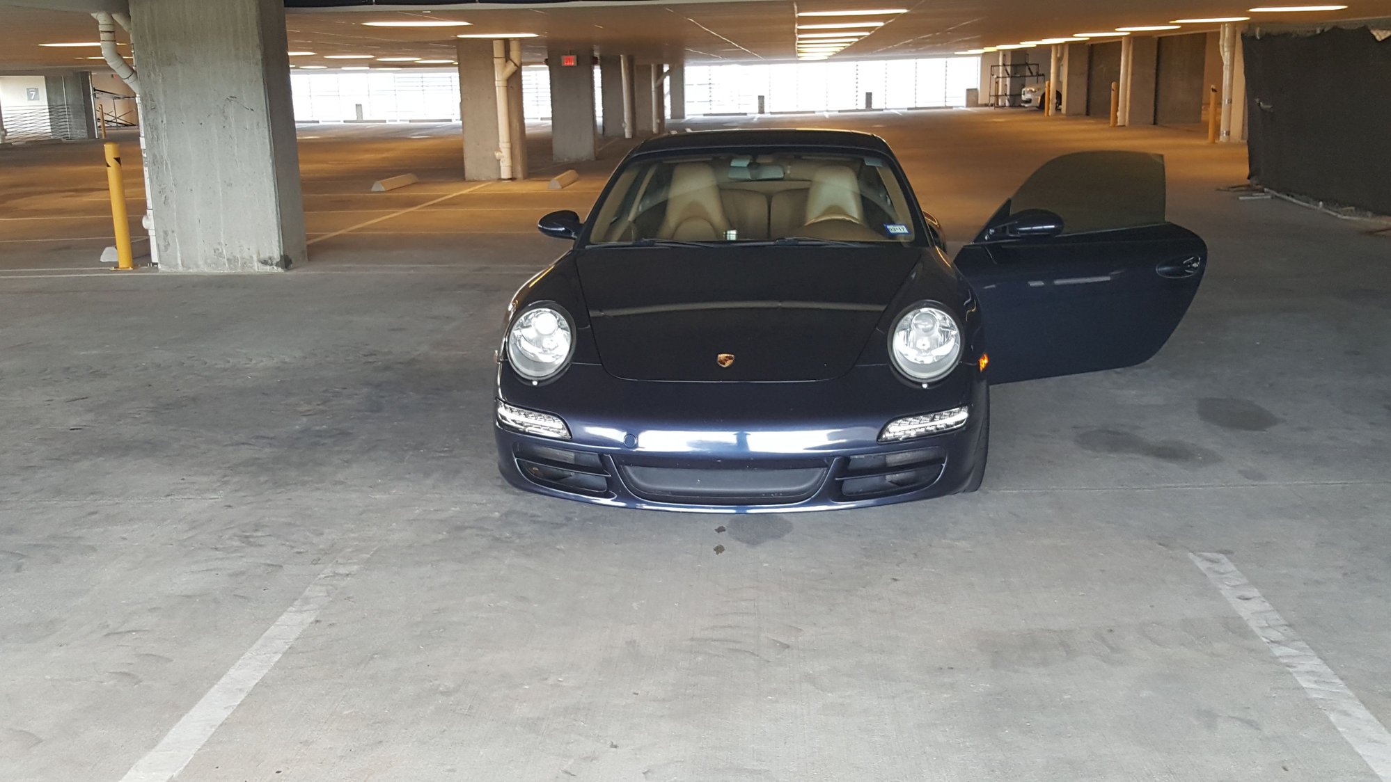

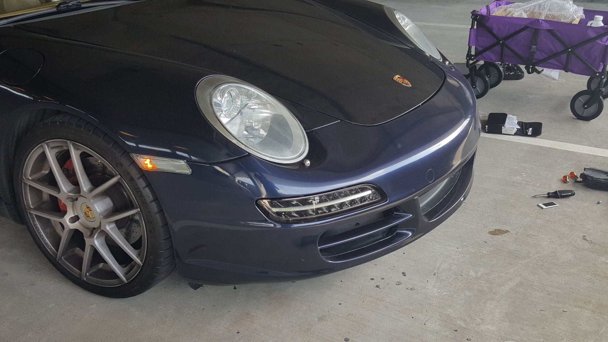

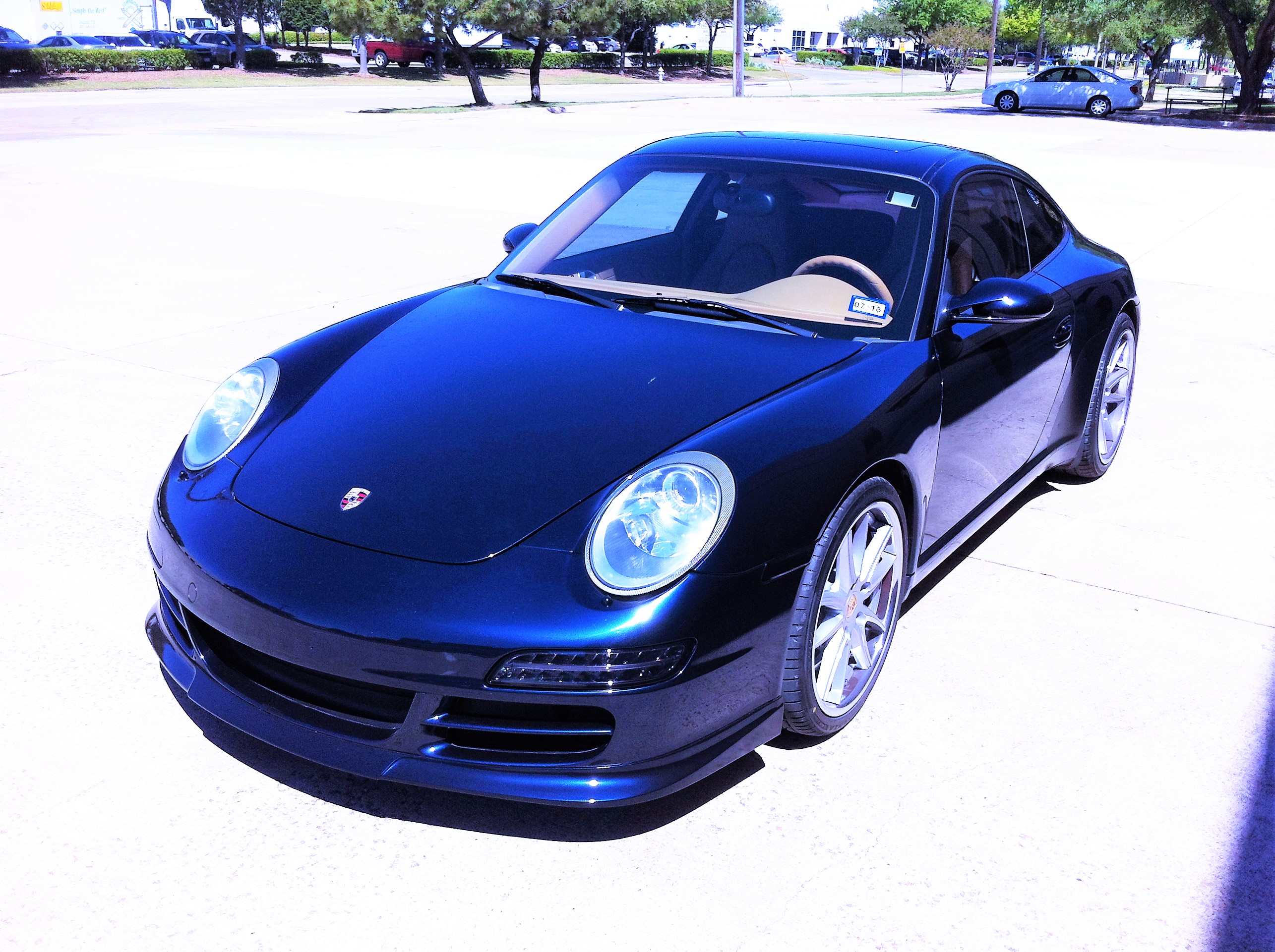

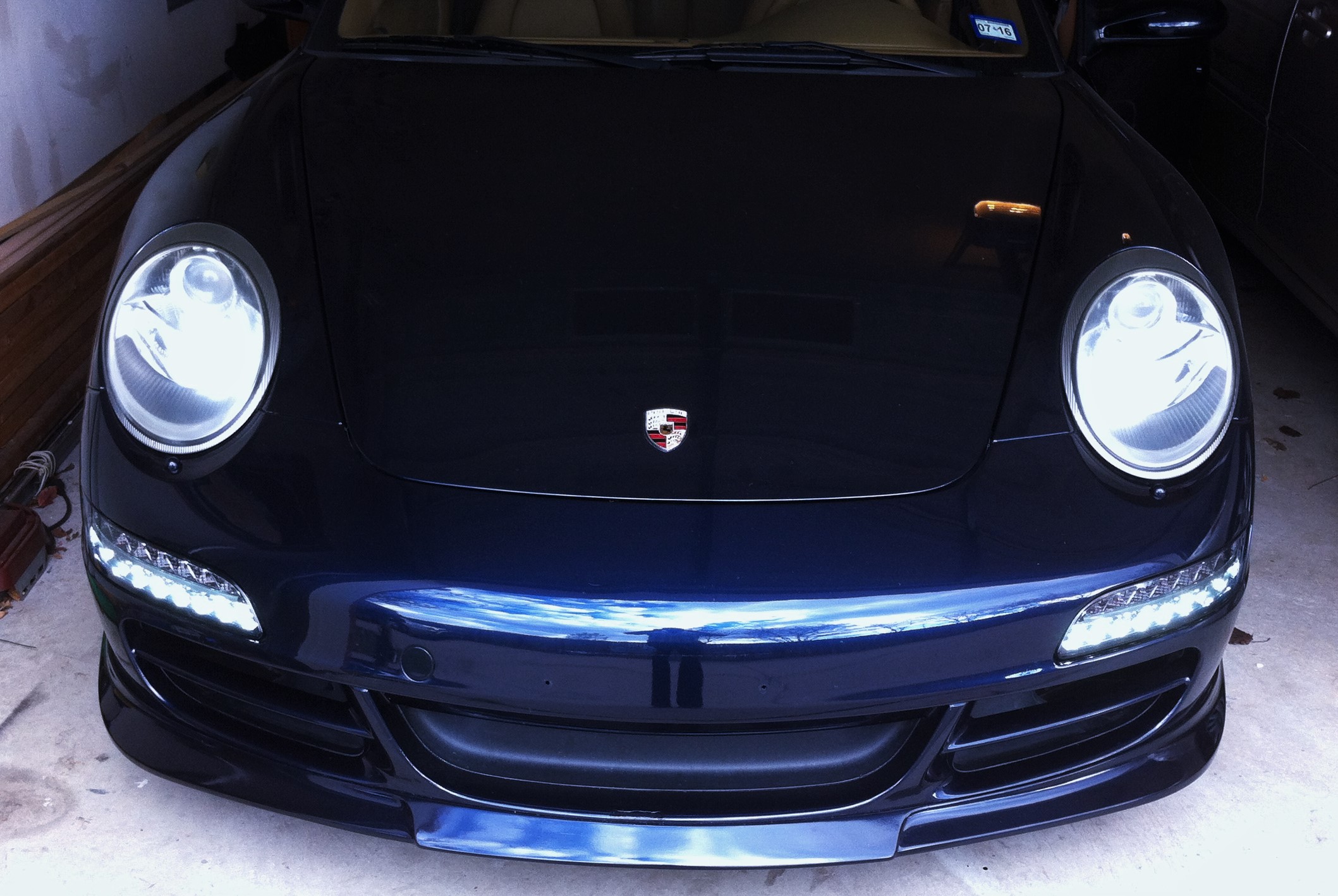

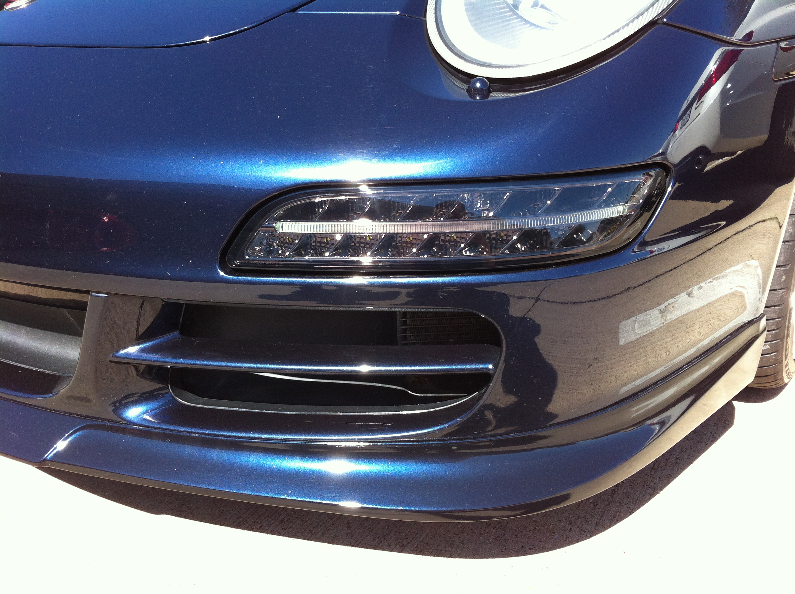

I bought mine on ebay. My first set within 2 months, one of the LED burned. I don't know if its from my extra wiring or a bad batch. So I bought a second set. So far everything works knocking on wood. I bought the smoked version. It look better on dark color cars, IMO. What I don't like about it is the center parking strip. They're not very bright. I hardly use it any way. So it doesn't matter to me. I used the foglight as DRL.

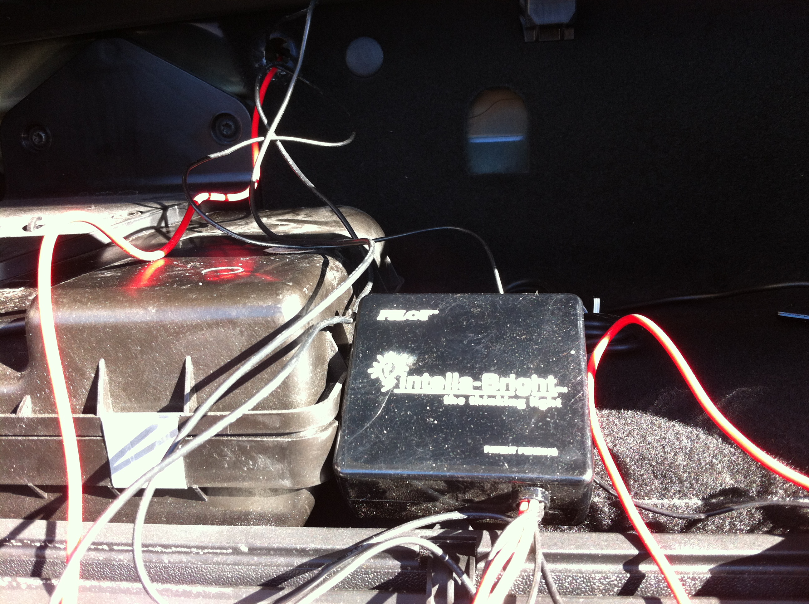

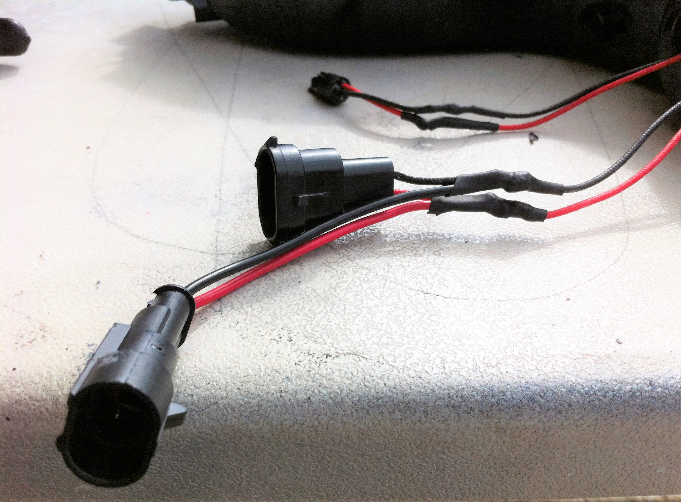

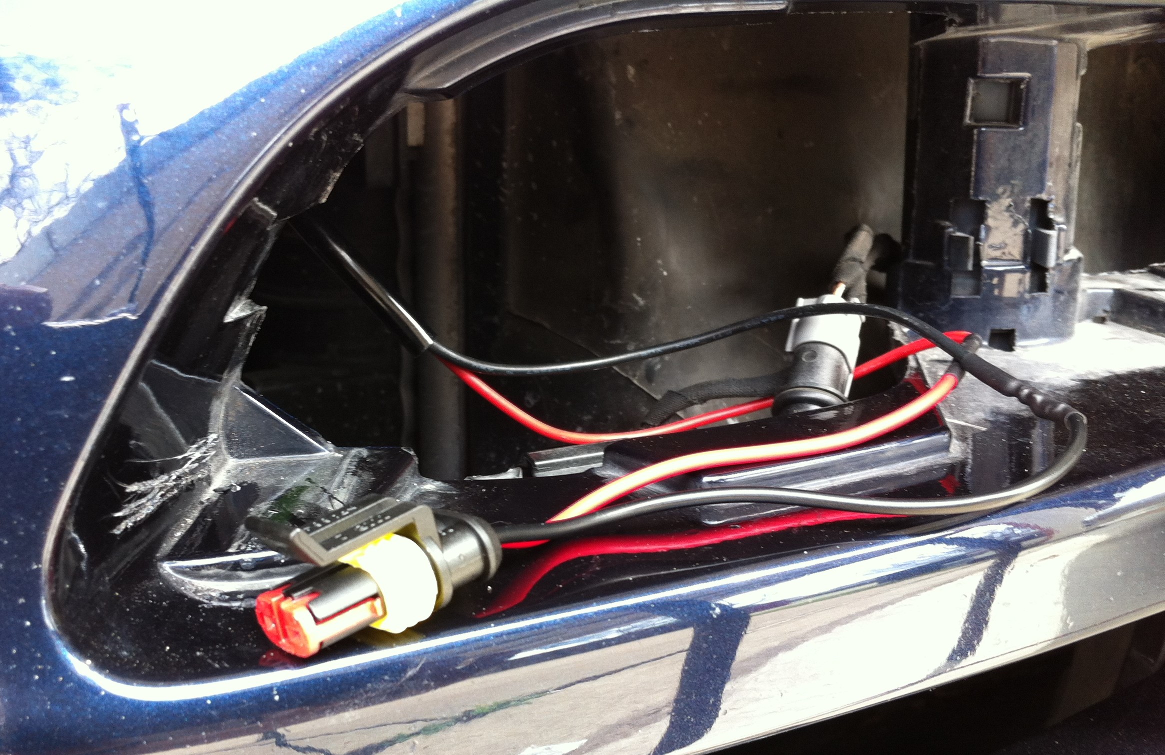

that's one simple solution you can do from the link above. I just didn't want to tap/cut into the factory wires. I bought an auto on/off DRL module & wired the LED foglights to the module. I used an easy connect plugs & piggyback to the LED foglights. The cool feature about this module is that lights comes on for a few second when the door's open, turn on/off the alarm.

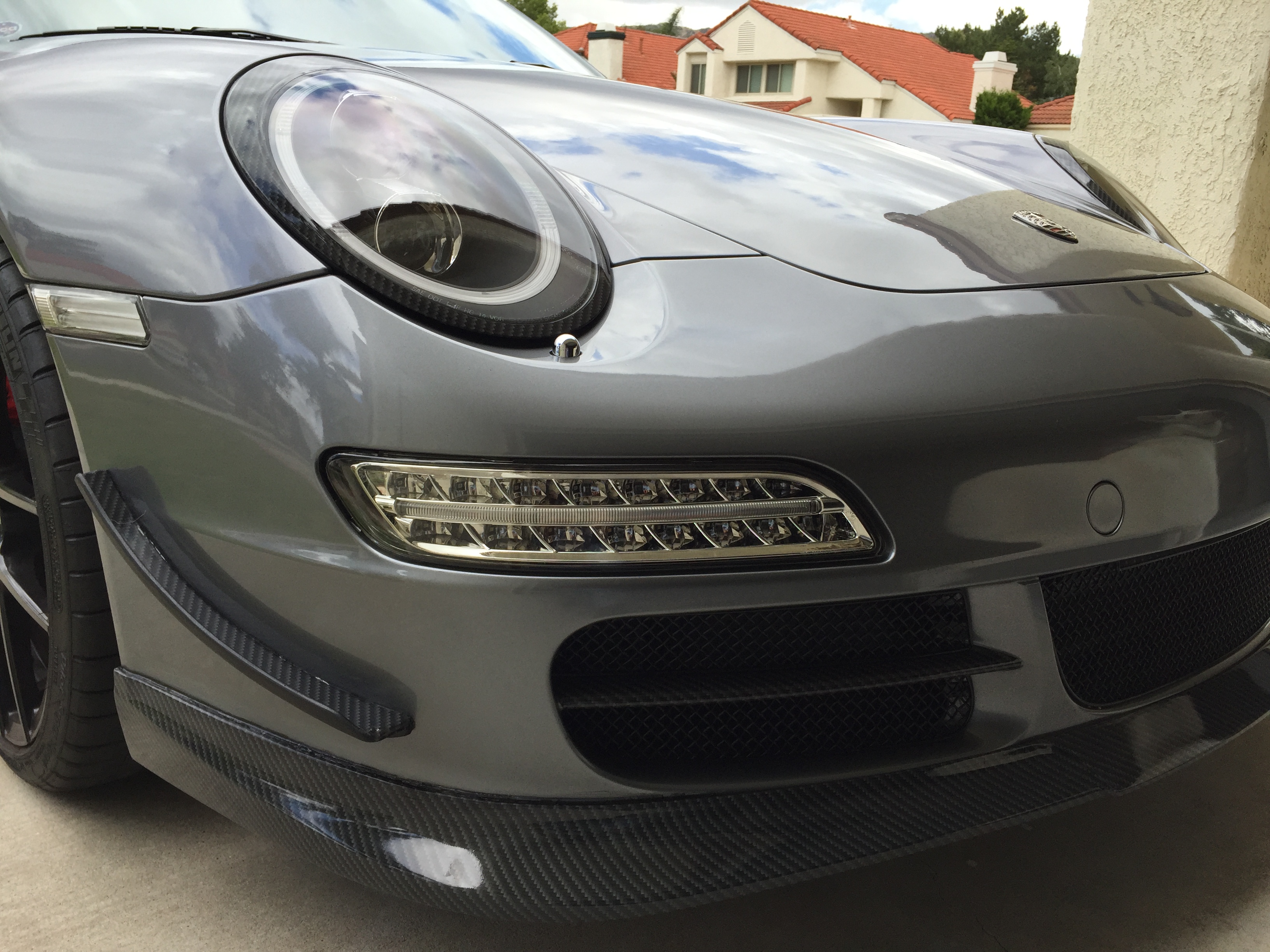

The spoiler looks like a GT3 Tek product (poly type). I have one too, great fit.

I bought a Pilot Intella-Bright DRL module on ebay a few yrs ago. (2nd pic above). I don't think they sells them anymore. Just search on ebay for DRL relays,module,switch, etc. & look for the auto on/off one. Don't buy the cheap one as they don't last very long.
