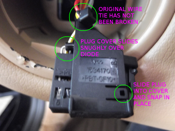

Utkinpol II with Pictures & Tips
I completed the Utkinpol II DRL hack today. Here is my experience with some tips and pictures...

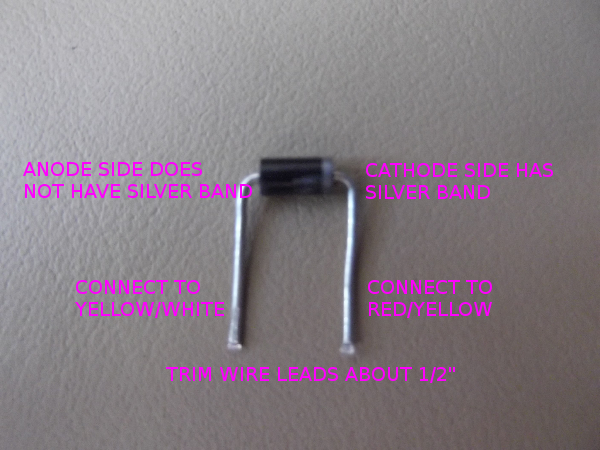

(1) DIODE
As suggested, I purchased the IN4001 Micromini Silicone Diode 50V/1A from Radio Shack.
(2) REMOVE LIGHT SWITCH
I removed the light switch by pushing in the light switch ****, in the OFF position, and turning gently clockwise until it clicked (half way between the OFF and HOME positions. Then the switch just slides out. Unplug the Light switch from the wiring harness and plug.
TIP: Be careful... The beautiful paint on the circular trim piece that seats the light switch is extremely delicate. Even slightly scraping it with the wire harness will cause it to peel. I suggest placing or taping an index card there so you don't accidentally remove your paint. Do not put tape on the trim paint itself, however. Now, I will be shopping for Sand Beige interior touch-up paint to repair this. I might try Testors (http://www.testors.com/products/543912) or Home Depot color code 697912143052 (https://www.6speedonline.com/forums/...-up-paint.html).
(3) REMOVE THE WIRE PLUG
TIP: No need to cut the black wire-tie. Here's what I did...
Instead of cutting the wire-tie, I was able raise the release clip (see picture 1), insert a small screw driver in the slot next to the clip, and slide the plug out of the plug cover.
The yellow/white and red/yellow wires are clearly visible once the plug is out.
(4) PREPARE DIODE
TIP: No need for shrink tubing or wire tape. Here's what I did...
The diode can fit nicely inside the plug cover. Bend the wire leads 90 degrees, close to the diode, as shown in picture 2. This will be just wide enough for the diode to fit between the yellow/white and the red/yellow wires on the plug. Cut the diode leads to a length of about 1/2"; the lead lengths should be long enough to reach up to the windowed metal "triangles" shown in picture 3.
(5) INSERT DIODE
Slide the diode leads into the plug, along the yellow/white and the red/yellow wires. The cathode (the side of the diode with the silver band) must be inserted along the red/yellow wire. Again, picture 3 shows how this should look.
TIP: The diode side with the silver band goes with red/yellow wire.
(6) REPLACE PLUG COVER & REINSTALL SWITCH
Slide the plug with the diode back into the plug cover, and snap in place. Reconnect the plug and wire harness to the light switch. Then, insert the switch into the circular trim piece on the dash, gently push in the light switch ****, and turn counter-clockwise.
(7) MY EXPERIENCE
I typically keep the light switch in the OFF position, but I will now begin using the HOME position.
The bumper-lights (DRL) turn on when the light switch is in the HOME position. When the car is off, after a few minutes, the bumper lights turn off automatically.
I noticed that, if I unlock the car using the remote key, the bumper lights turn on. Then, if I do not open the door to start the car, the bumper lights turn off after a few minutes, but the interior door lights stay on. After some more minutes, the car automatically locks itself and the interior door lights turn off. I did not notice this before and it might just be normal behavior. Does anyone know if this is normal?

wow this is awesome! thanks for the high res pics. so just to be clear you didn't actually remove the wires from the plug as some were doing previously? i purchase the same diode from radio shack but mine doesn't have the grey stripe. is that really important? Thanks
Yes it does. The grey/silver stripe is the cathode side (-). The way a diode works, is it controls which direction the voltage will flow. Thus you need know which side is the cathode or anode.
Correct. I did NOT pull out the individual wires. The diode lead wires fit snugly enough in the holes to make make good electrical contact. The way I put the diode inside the plug cover makes sure it will not fall out. (Besides, it looks better, for us OCD types ) Also, I did not remove Porsche's little black zip wire tie, so everything remains tight and secure.
As na001 pointed out, this is important. Look at the back of the packet from Radio Shack. There should be a diagram that tells you how to identify which side is the CATHODE.
