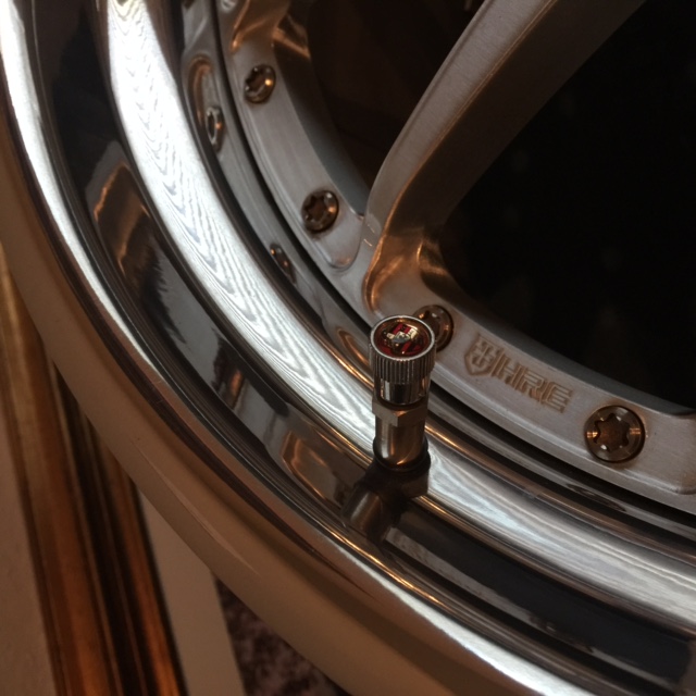

Took wheels/tires to shop today to find out the rear wheels aren't provisioned for OEM TPMS...what options do i have, anyone experienced similar issue?

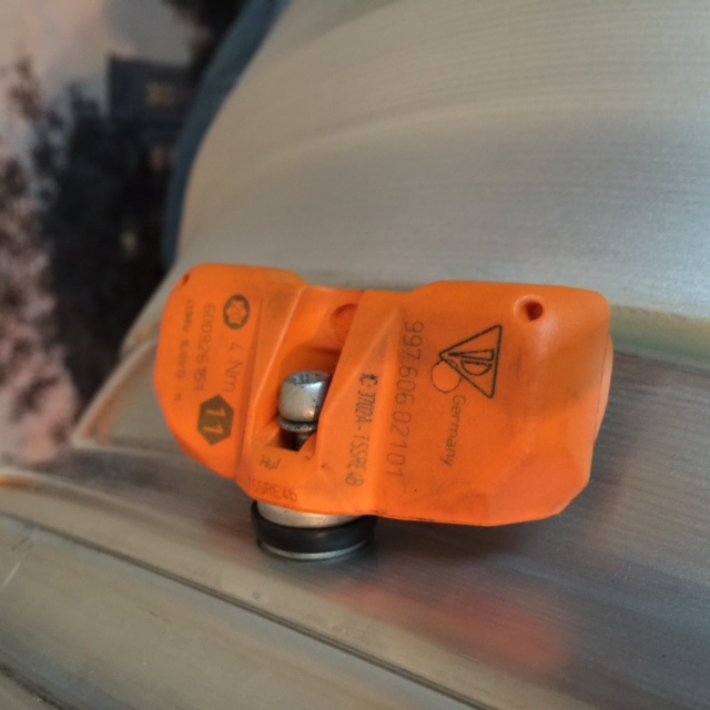

Bought used, previous owner had the 3.5" lips replaced new by HRE, his 911 was pre-2007 maybe that's why the valve stem holes are different than the front. The brackets should work with bolt-on 6 mm stems, i will call WE tomorrow.

Thank you but that won't work, TPMS positioned too close to outer bead.
Dave Martin gave 3 options:
1. Enlarge the 6mm valve stem hole
2. Ship wheels to HRE
3. TPMS strap (last resort)
Apparently these wheels are C93 produced before TPMS was mandate...it is odd that the fronts are but not rear.

called couple wheel repair shop, first one don't modify wheel due to liability, second shop estimate $85.00 per wheel (as soon they asked what type of car i know it's cha-ching time).
After some research I decided to do the job myself. With a carbide step drill bit and lot of patience, for $19.95 + 1 hour I did an awesome job.
The bit is bad ***...super clean cut.
Can't wait to get these mounted.
Thank everyone...

got the HREs mounted to tires, the TMPS sat flushed once torque to spec. Wheels are on the car now, no sign of pressure drop in last 4 days. Offset is perfect, rear wheel has 5mm clearance between brake caliper and wheel, that should be fine.
