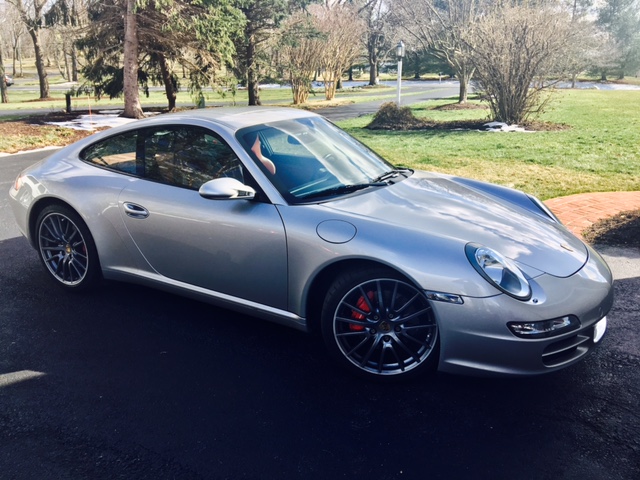

Louder exhaust and lower stance
Have 997S with PASM/PSE.
Too quite for my taste however don't want to lose functionality of PSE. What is best exhaust mod to achieve louder exhaust without losing PSE function?
Would also like to lower stance without losing PASM function. Will a set of lowering springs do the trick and still allow PASM to work as designed?
Finally, what is recommended spacer width frt/rr to achieve wider stance?
Pic of 'new to me' 2007 997S

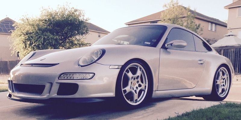

I had H&R Springs and I didn't lose my PASM; I switched to BC Racing and I lost PASM. I can't say I regret losing the functionality. After several weeks at this ride height I'll be slightly raising the car a little, and also adjusting the damper setting as it's a little soft - it has dual settings. I ended up having to remove the spacers when going over dips in the road but I suspect I need a better alignment as I found the INDI shop didn't dial it in.
BC Racing
H&R - has a rake and rear is slightly higher than the front :-/

[QUOTE=gonz996;4627854]I had H&R Springs and I didn't lose my PASM; I switched to BC Racing and I lost PASM. I can't say I regret losing the functionality. After several weeks at this ride height I'll be slightly raising the car a little, and also adjusting the damper setting as it's a little soft - it has dual settings. I ended up having to remove the spacers when going over dips in the road but I suspect I need a better alignment as I found the INDI shop didn't dial it in.
WOW, picture #2 seems quite low to me, nice ride though, KH

When I picked it up at the shop I thought it looked cool but honestly it was lower than I expected. I wanted zero gap, but instead it's tucked a bit. I also think the alignment is not correct and I'll be having this done after I notch it up a bit.
I think the camber is off as even after removing spacers there's a slight rear rub on the right rear and/or the setting is too soft.
I was rather in a rush as the install was right after my employer transferring me to OKC.
I'll be playing with the ride height this weekend and look forward to remounting my 15mm spacers on all 4 corners.
