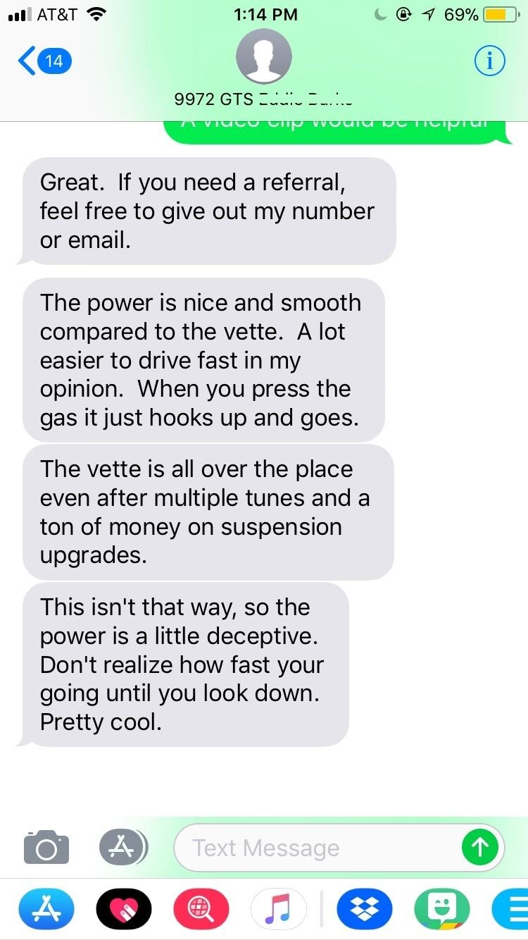

Old Feb 27, 2018 | 01:58 PM
VF Engineering's Avatar
Joined: Apr 2012
Posts: 376
From: Anaheim, CA
VF Engineering is a jewel in the roughVF Engineering is a jewel in the roughVF Engineering is a jewel in the roughVF Engineering is a jewel in the rough
Originally Posted by Caleb Lester
Any guys out there with this on their 997.2? Ready to either go with this or just opt for a 997.1 turbo as it really is close to the same price difference
We've actually got a customer in Texas that we might be able to connect
you with! (we know it's a big state, so feel free to PM your zip code)
He was over the moon with his system, and has quite a bit of aftermrket
experience with other brands.
Old May 18, 2018 | 09:12 PM
Caleb Lester's Avatar
Joined: Jan 2018
Posts: 4
From: Texas
Caleb Lester is infamous around these parts
997.2 supercharger referral
Still hoping to hear from you guys... I’ve called and was told I would get a return call back twice and emailed as well that I’ve been ready to buy the kit just that I had a couple of other questions and hoped to talk to someone who has one/see a video etc
thanks

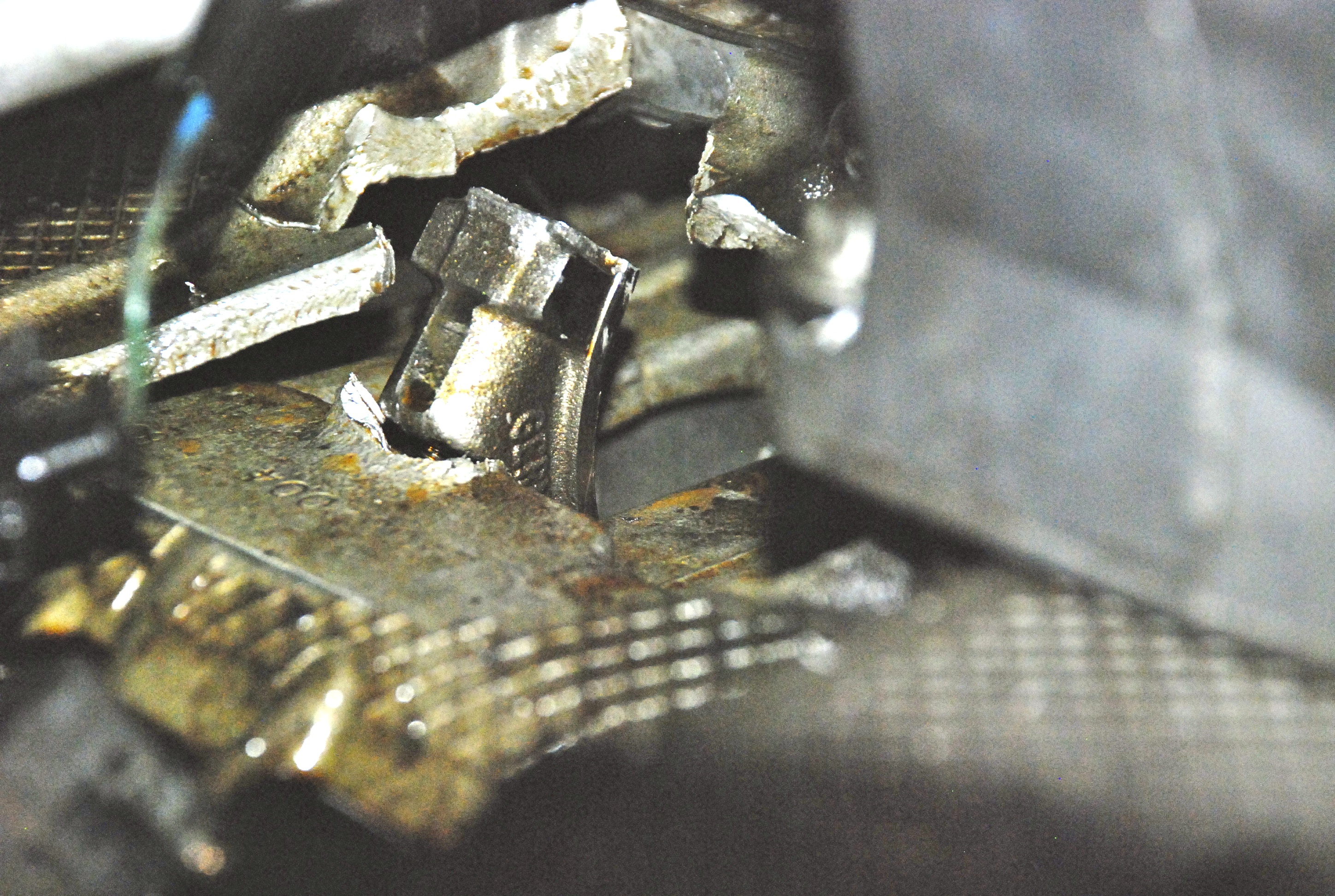

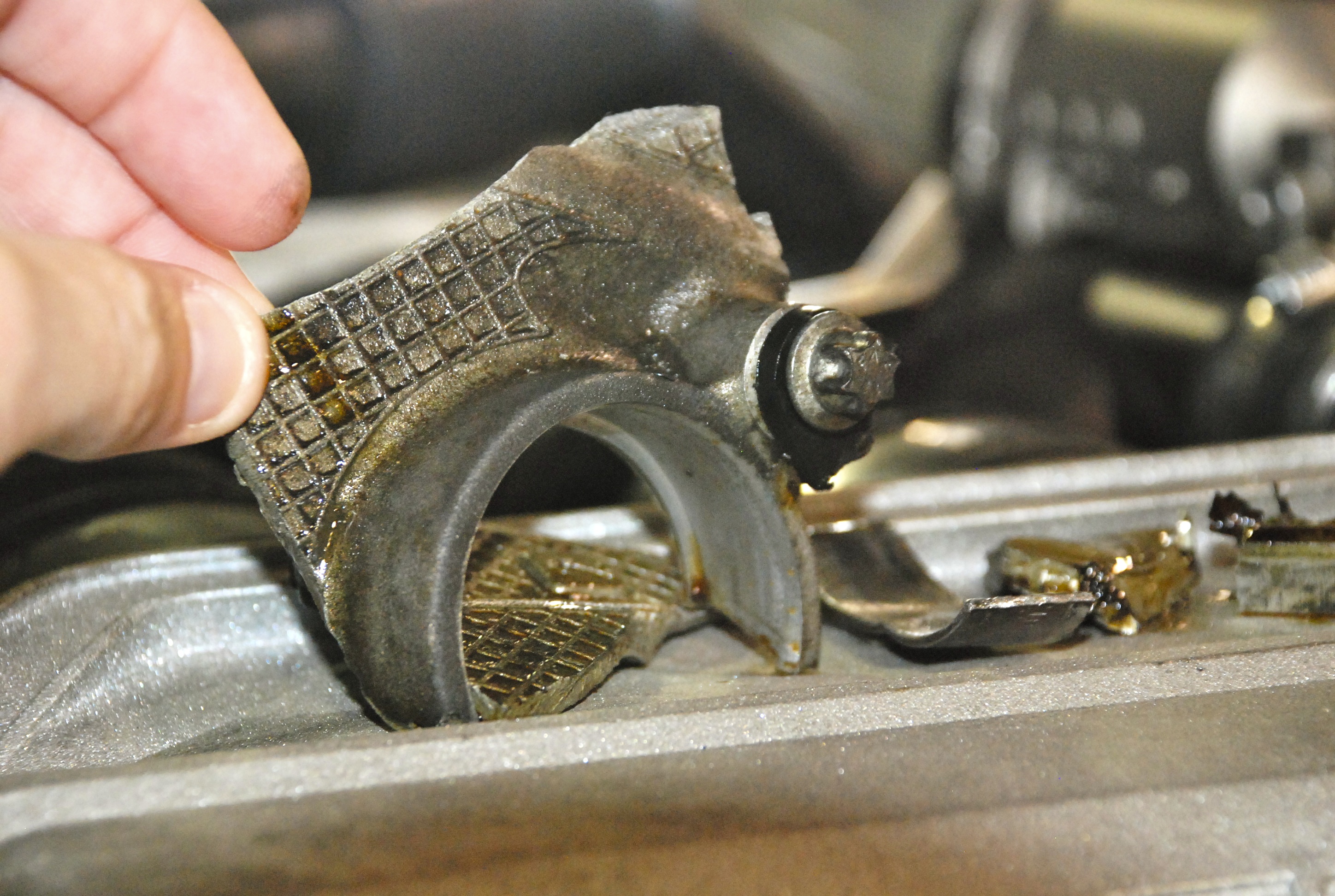

VF-E makes a great kit- I had one of their very first.
I found that their kit did not produce the 6.0 psi boost advertised, and I thoroughly tested it at the throttle body, so I used a smaller pulley, which required one other small adjustment that I won't share here to further "trick" the ECU.
The power and performance were addictive.
However, and I am not directly implicating the SC, but my engine exploded while running their SC. Here are a couple of photos of the shrapnel. There were a pair of fist-sized holes punched through the block.
Other than that, how was the play Mrs. Lincoln?
That said, if VF-E were to contact me and offer me a deal on their update kit I would gladly do it again, and would in fact produce a professional quality video of the installation process.
CATTMAN
