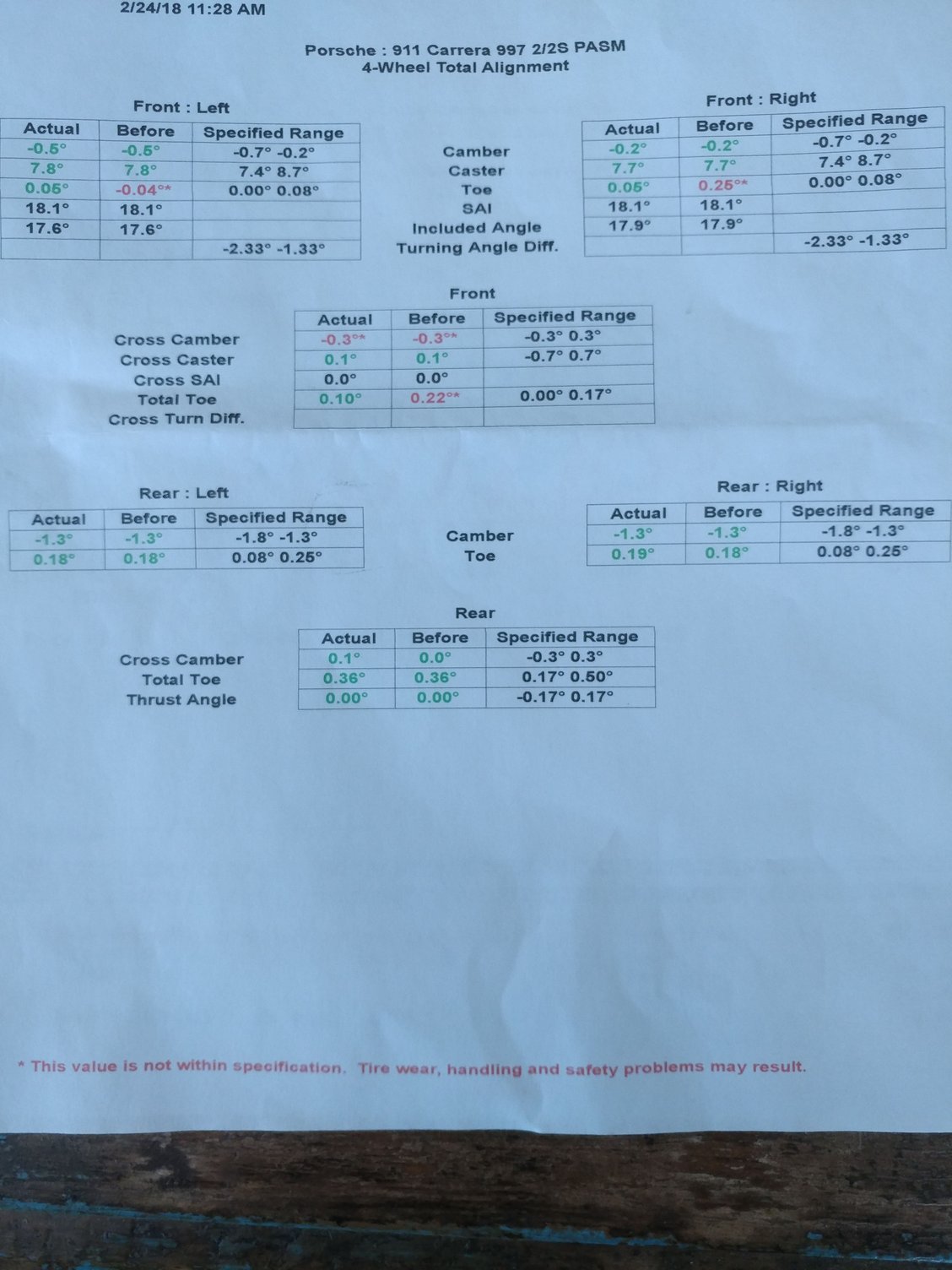

Inside rear tire wear is normal with the factory alignment specs. It can be reduced go altering those specs with less negative camber and less toe in to prolong tire life. I just had my wife's C2S aligned over the weekend and can post up the settings I use for it that gets her about 20,000 miles out of a rear set of Hankook Evo2 tires, but she doesn't drive the car very aggressively, so we're less concerned about absolute handling and more focused on tire wear. If you drive the car aggressively, you may want slightly less conservative #s, but I drove it home aggressively and it handles fine up to 6 or 7 tenths. Below is the alignment sheet on this one.
