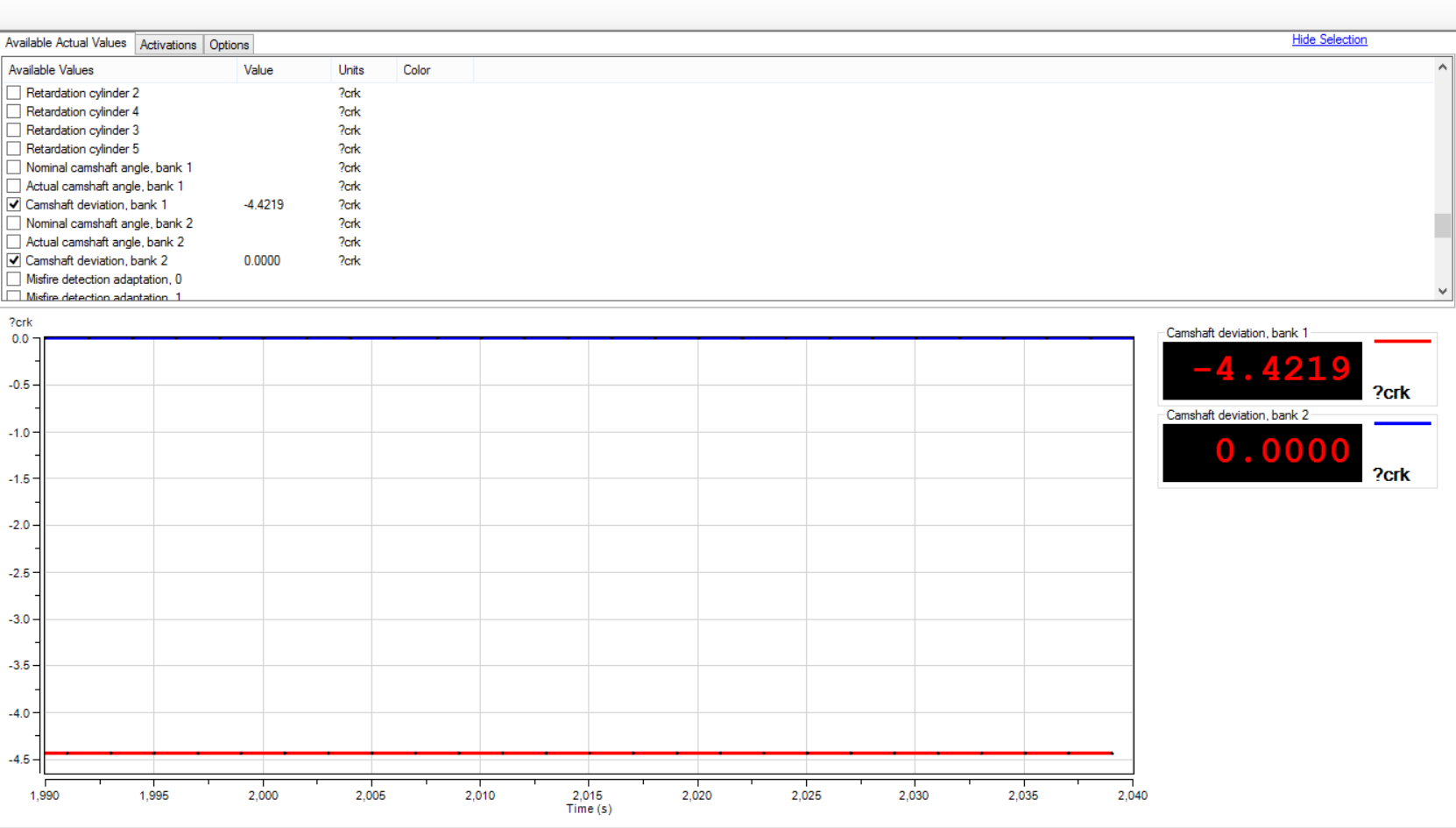

can someone let me know if these values from 02 sensors reading are way off on both banks

Read the Bank 1 and Bank 2 camshaft deviation numbers. My car had exactly this same behavior when the camshaft position sensor failed. When the car is first started it runs in open loop so ignores those sensors which is why it runs fine for 1-2 minutes. Then it switches to closed loop and when it doesn't get the data from that sensor it throws the code and starts stumbling. I bet if you pull those values, the bank 1 sensor that's throwing the code shows all zeros.
