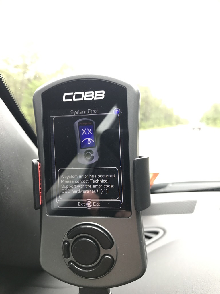

Recently my car had been sitting for a while due to getting a wrap installed on it and also sitting in the shop getting some issues sorted out and as a result of this my battery died. Tried charging it but that didn't help so decided to swap in a new battery. After the battery swap, my Cobb AP has been acting weird and not communicating with the ECU.
It's coming on when I first start the car up and goes to the gauges screen for a few seconds and then gives me an error message of not being able to communicate with the car or a system error. Below are pictures of both error messages. Since the error message says "OBD hardware fault" I checked both ends of the OBD cable and both are in tact, no bent prongs or anything. The cable itself is fine as well, no slits or tears. I updated the firmware by connecting to accessport manager and that didn't help either.
Any ideas on what could could be causing this or has someone else experienced this? I've contacted my tuner about it and I'm thinking I should contact Cobb as well but just figured I would ask here first. Maybe it's something simple

Not uncommon. Cycle the key, and pull and plug the cable back into the OBD port. You may need to do this 10-15 times before it'll connect back. Happens every now and then to most of us for unknown reasons. Some say doing a code clear/ECU reset helps some too.
I will say that the hardware error is not normally seen though. If you can't get it to connect after doing the above, contact Cobb. You'll likely have to send your unit in.

I tried cycling the key and plugging the cable back in. I was able to get it to connect to the ECU and read codes & cleared codes or "reset ecu" from the troubleshooting menu. The accessport worked for about a day and I just got in the car yesterday to take it for a spin and it's giving me the same error again.
Is Cobb on this forum? I've asked my tuner about it and he said he has not seen this OBD error before.

They can be quirky at times if there is a voltage thing or the connection is bad or even just random. If you call Cobb Charles will likely pick up and help you go through a few things. I say connect to AP manager and do a firmware update. Then go back and you will likely be ok. There have been several updates since you got your unit. Feel free to call me!

Had this happen to me, sent an email to Cobb and they ran me through some troubleshooting then replaced my cable with a new one, which fixed everything.

Hey Sam. I actually did a firmware update as one of my preliminary troubleshooting steps right before I made this thread and it didn't seem to help. I'm going to mess around with the cable and spray some contact cleaner on it and see if that does anything. I'm sure you'll be getting a call sooner or later once I get frustrated with trying to make it work

I emailed Cobb support this morning. Hopefully they get back to me soon. Nice to know I'm not the only one who's experienced this. Maybe this will result in a faulty cable as well. I'm just hoping I don't have to send my accessport in to them.

Cheers buddy good luck. The cable may have gotten pinched or damaged as well. They do take calls too. Good luck!

I spoke to Eric. Just FYI Cobb got back to him via email in hours. I suggested he call and they shipped him a new cable on the spot. It may have gotten kinked or damaged but they sent him a $70 cable no questions. When you hear about a few issues out of thousands of clients and they get solved like that I'd say they get an A+ and that's another reason I love Cobb.

Cobb is sending me a new cable to try out no questions asked and free of charge. It should be arriving today and I will comment back on if that fixed it. They have been a great company to deal with as well as Sam @ ByDesign and I suggest you talk with him about tuning options before you make a decision!
