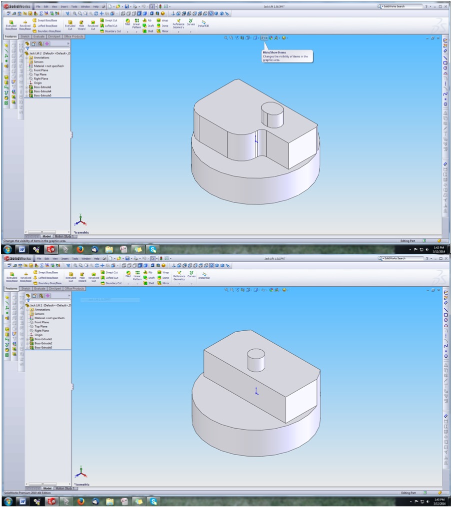

I have foam core prototyped and worked up a solidworks file for Aston Martin Jack Pads. As most of you probably know, there's a weird little cutout in the sill at the jacking points, and a little hole where the chassis is mounted on the production line.
Many people have been using hockey pucks, blocks of wood etc, when jacking their cars up. These will work, but of course there's always that nagging doubt about whether it is properly secured, cars falling off the jack, damaging the sill etc.
The pieces I have designed will sit in the cup of a standard jack. The little nub that protrudes is actually separate from the shaped slice. This means that to use the pad on the opposite side of the car you lift the contoured piece off and flip it 180 degrees. Front & Back are different shapes so there's one piece for the front, and one for the back.
The little holes in the sills are lined with a recessed rubber grommet, so the nub should actually be snug enough to hold the pad in position while you position the Jack. No more guesswork, no more blocks of wood.
We're aiming to produced these machined out of billed aluminum (or aluminium ). I can do this at a price of $89.95 per vehicle set. I know, I know, you can get jack pads for a Honda for $20, but economies of scale and all that.
I haven't pulled the trigger on these yet, looking to get some feedback. If I can get an even dozen we could get this into production.

would it be usable on DB9?

I designed these on a Vantage, but I am told by an Aston mechanic that the cutouts look the same on all the cars, so I *Believe* that they will work on all the Gaydon Era cars.

They seem a little too specific. You should get a DB9 and make sure your design is truly universal to Gaydon cars. Also, I don't understand the part about the nub being separate. Are you saying there are 3 pieces, or is the nub part of the rectangular block? Or is there a nub on both sides of the rectangular block and a hole in the circular part so the rectangle can be flipped to 'hand' the puck?

Sounds like you would need two sets if you wanted to jack up the front or rear of the car from both sides?
