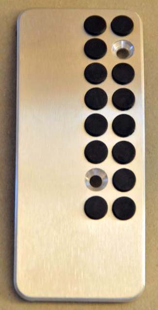

Thanks again for the lead. Actually, I didn't reach C2 Design who I would have used based on your recommendation if they had answered the phone (closed for the holiday?). But, Ultimate Pedals (online/phone) had the pedal template in their files (same as DB9 2005) and is making a peddle to match the stock pedal (mounting holes, brushed finish, beveled edges, etc.) but with an extra inch of undrilled metal surface on the left side to "blip" with right side of foot while braking and downshifting - sounds similar to what C2 Design did for you. I'll let the group know how the pedal looks and works when I get and install it.
Belated update - very pleased with the pedal from Ultimate. The fit and finish are great and the 1" extension works well for me - if redoing I would probably stay at 1", or consider wider extension, not narrower. Hole pattern is laid out so mounts with stock mounting screws after unscrewing stock pedal - screws go in 2 holes without rubber pads in photo.

In view of your interest, I went to the garage and measured gap between the brake pedal and the gas pedal with 1" extension in my 2006 Vantage. At the widest part of the brake pedal the gap is 1 3/8", at top and bottom of brake pedal the gap is a bit over 1 1/2". It would be easy enough for you to get a sense of the fit by cutting a piece of something like shirt cardboard and taping or clamping it to the pedal (which is how I chose 1", see below).
I learned to "heel toe" in formula 2000 cars where you don't actually use your heel - you use the left side of the ball of your foot to brake and roll your foot to the right to "blip" the gas for downshifts with the widest portion of the right side of your foot. In those cars, the pedals are separated by about 1/2" and the gas pedal is set lower than brake so when you are hard on the brake the gas is just below your foot to be easy to roll on to.
As I understand it, we can't adjust the height of the gas pedal in our Vantage cars (if we could I would have made extension a fair amount wider), so you need enough clearance to not hit gas when you brake, except intentionally. For me the 1" extension works with track shoes (narrow) or sneakers (size 10D). But, best answer is mock it up with some cardboard or sheet metal attached to the stock pedal to see what you like. Ultimate made the pedal to my specs - match stock pedal (stock curve, brushed finish, 1/16" bevel around edges, square rubber pads) and add 1" on left. I am sure they would adjust extension width to whatever you would like - they didn't have anything listed on web that was what I wanted, so I called and they said they could make it up however I wanted - got it in less than 2 weeks.
They sent me a template that I printed out in actual size and transferred to cardboard, added a lot to the left side, then I put it in the car on gas pedal and cut it down until I was happy with it - the cardboard extension to the left of the stock template shape was close to an inch when I was done, so I rounded to 1". I have tried to attach the template in case you'd like to try that approach - be sure to print full size - set "scaling to none" when you print.
Once you decide on the extension size, I am sure Ultimate, or the shop Michael recommends, could do a nice job for you.
